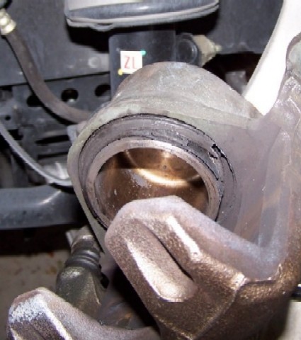

Looks like the dealers won't replace under warranty.
Apparently, they don't condone track events or even autocrossing.
I wonder if Porsche or BMW dealers treat owners this way.
They sponsor track events for their customers...
Here is a pic:

That's nothing, you haven't even burned off all the paint on the caliper yet! Wait till all the paint turns white... Just kidding, not much you can do. I would ignore it. As long as you clean it before you push the piston back in each time, it should be fine.

Looks very similar to my E28 BMW after a weekend track event. Main culprit was the Metalmasters I'd use. Cornerworkers commented on the sparks flying at the end of long straights.
Best solution is finding a pad that won't throw off material easily, ie. a good hard track pad. It's not just the temps.
I'm using AXXis ultimates up front and had postive results at one session late last year. But they are not a true track pad and could overheat on a long track.
I always had extra rebuild kits and got pretty good at it.

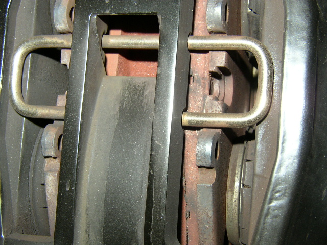

My Stoptech boots are toast. Not sure how long, but any boot will melt under the braking we do on the track. Like Jason, I don't worry about it. So now we all know why true RACING brakes don't even bother with them.
Attached Thumbnails Brake Caliper Piston boots cooked!-brakes-10-3-2-f-dust-boots.jpg

Its about time to change those pads Enthuz! I spent part of the day bedding mine in for this weekend. I'll really get to test those ducts at VIR south.
Old Apr 7, 2004 | 04:02 PM
EnthuZ's Avatar
EnthuZ
Posts: 1,965
From: Chicago Burbs
Yah, your right, they were JUST touching the rivets!
I still haven't gotten my cooling duct kit.
Let us know how it works.
