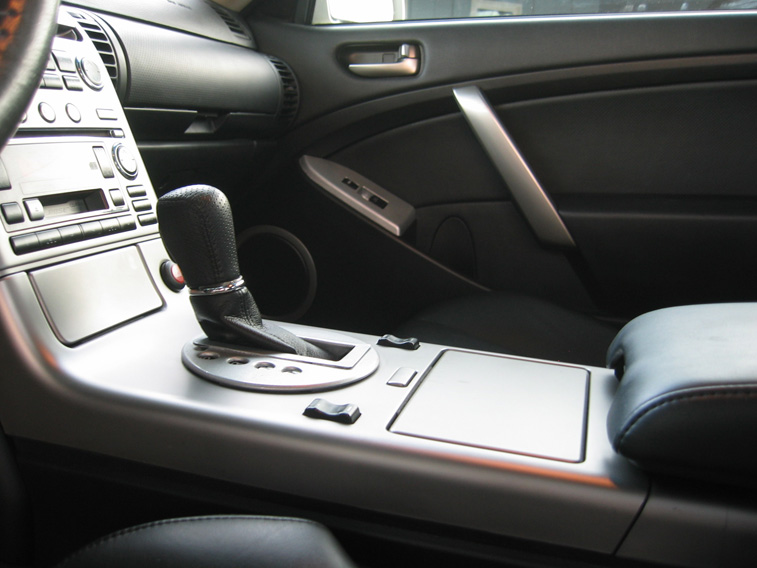

Here's mine. I didn't want to really trying make it look like a manual, but just to replace it with what I consider the best looking OEM auto **** out there.
I have a brief DIY somewhere on G35driver. **** and boot from everythingnissan.com, had to call them up. Total cost is about $100.
Attached Thumbnails How To - Shift knob for 5AT-interior-009a.jpg   How To - Shift knob for 5AT-interior-011a.jpg
