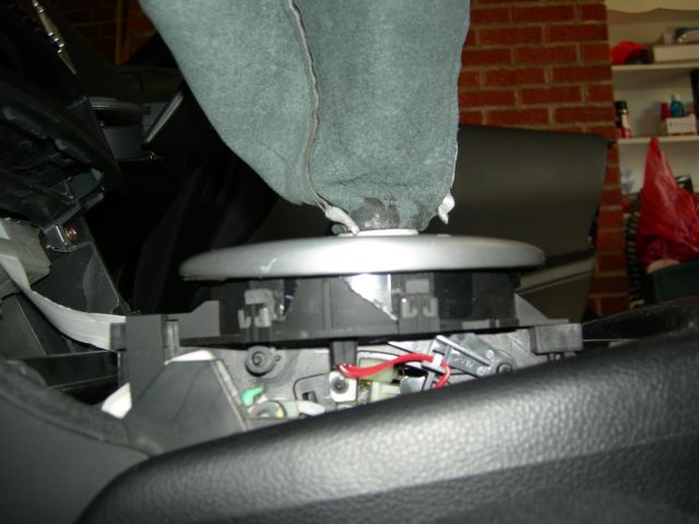

Here are some pictures of how the ring fits in without the console piece;
As you can see there are some wide pieces of plastic that go around the trim ring. The ring only goes on one way, so I put a Small mark at dead center of the ring so I know its exact position to be mounted.
I then removed the bulk of the “Tabs” around the ring, leaving only the places that it snaps in. This also removes the centering “Channels” on either side that makes the ring fit so tight. All of this cut out was needed to accommodate my Momo Boot with the Piping.
I then fit the boot over the entire area; I re-installed the console and then pressed the ring down with a few taps of a rubber mallet.
Attached Thumbnails How To - Shift knob for 5AT-ring-driver.jpg   How To - Shift knob for 5AT-ring-passenger.jpg   How To - Shift knob for 5AT-ring-driv-cut.jpg   How To - Shift knob for 5AT-ring-pass-cut.jpg   How To - Shift knob for 5AT-boot-over-all.jpg

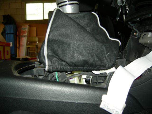

Here is the finsihed Product, I choose the Aluminium Version of the **** to compliment my HU and the Silver Piped Momo Boot;
Removing the blue plastic extender makes a huge difference in how the car shifts in Manual Mode, It just a quick flick of the wrist!!
