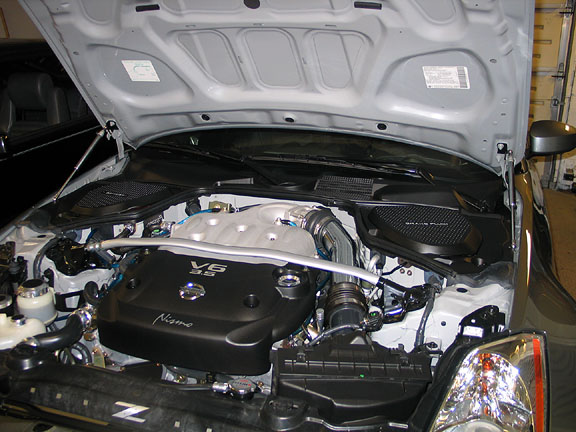

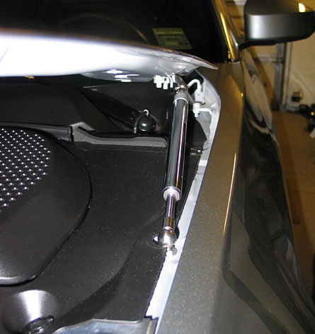

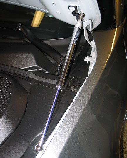

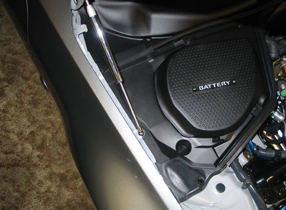

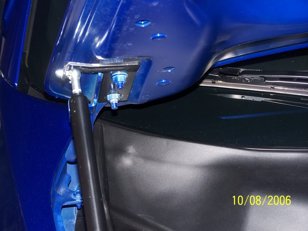

Okay. I was thrilled to receive my NRG hood dampers in the mail. When I opened the box all the necessary parts seemed to be included. Looking briefly at the small set of instructions, the install seemed to be pretty straight forward.
I began this task by removing the black plastic covers and proceeded to cut out the half circle with my Dremel tool that covers the fender bolt. The factory fender bolts will get replaced by the threaded ball joint. That is supposed to simply pop into the ball socket of the hood damper rod. There isn't any need to cut that circle too large.
After installing the hood bracket the dampers should just pop on to their respective ball joints, RIGHT? Well, I really leaned on these ends. No amount of pressure seemed to join these two items together. I finally got out my rubber mallet and with one quick whack I made these stubborn ends snap into place.
Here is where the initial 'open & close' test began and so did the clearly obvious problem. The last line on the instruction sheet states: "This item is not for Carbon or FRP Hood or non OEM Hood." ........and they're not kidding! I could see how a CF hood could crack or even snap in half. Out of the box, these things are rock solid.
Once everything had been installed, it was time for the moment of truth. From the fully open position, the hood refused to close. Not only would it NOT close, it wouldn't even budge. I carefully began to apply a little more pressure. However, this didn't work either and I started to notice that the hood was about to flex and bend. STILL it would not budge close. According to the HSPN TV NRG damper install video, http://videos.hspn.com/?videoid=9&catid=14
........it is recommended to initially depress the damper rods back and forth to ease each shock and this will help to promote better functioning.
I've replaced the hood dampers on my SUPRA and performing damper depressions was never a required step prior to the actual install. Well, since I had started this alleged quick job later in the evening, I thought that I would tackle the multiple damper depressions on the following day. I'll post the eventual outcome with some photos .......if these dampers finally cooperate.
Old Dec 16, 2006 | 04:07 PM
frankmusic's Avatar
frankmusic
Posts: 449
Cool Done!
A few tips to employ when you are installing the NRG hood dampers.
1. You don't have to cut that semi circle hole in your plastic covers very large. Keep it on the smaller side as shown. Use a Dremel tool to create that neat cut. It makes an overall neater visual appearance.
2. Straight out of the box, these dampers almost seem to be frozen. To loosen these up a bit, completely compress the hood dampers about 50 times each. If you choose not perform this step, you may run the risk of damaging your hood hinges or even the OEM hood itself. The factory hood is fairly light and more than likely flex before the extremely stiff hood dampers actually retract.
3. I used a healthy dab of wheel bearing grease inside the fittings before I popped all four of the ball joints together.
4. Contrary to the included instructions; Pre-assemble the hardware parts (extender, hood bracket and ball joint bolt) onto the actual dampers. Using this method will greatly ease the arduous process of successfully press fitting the ball joints together AWAY from your vehicle.
5. As shown, first bolt the rod stem end (with ball joint fastener) to the fender with a supplied washer. Then tighten it down.
6. Remove the upper hood nut from its bolt and place the hood bracket over the bolt. Tighten that nut.
7. Do perform the same sequence thing on the other side.
8. Now perform a careful test.

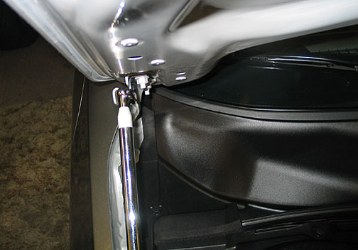

Here's what they will look like holding up your OEM hood.

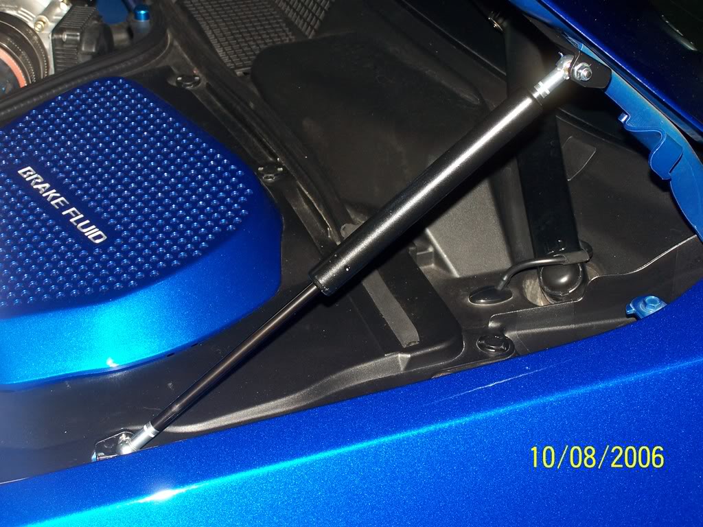

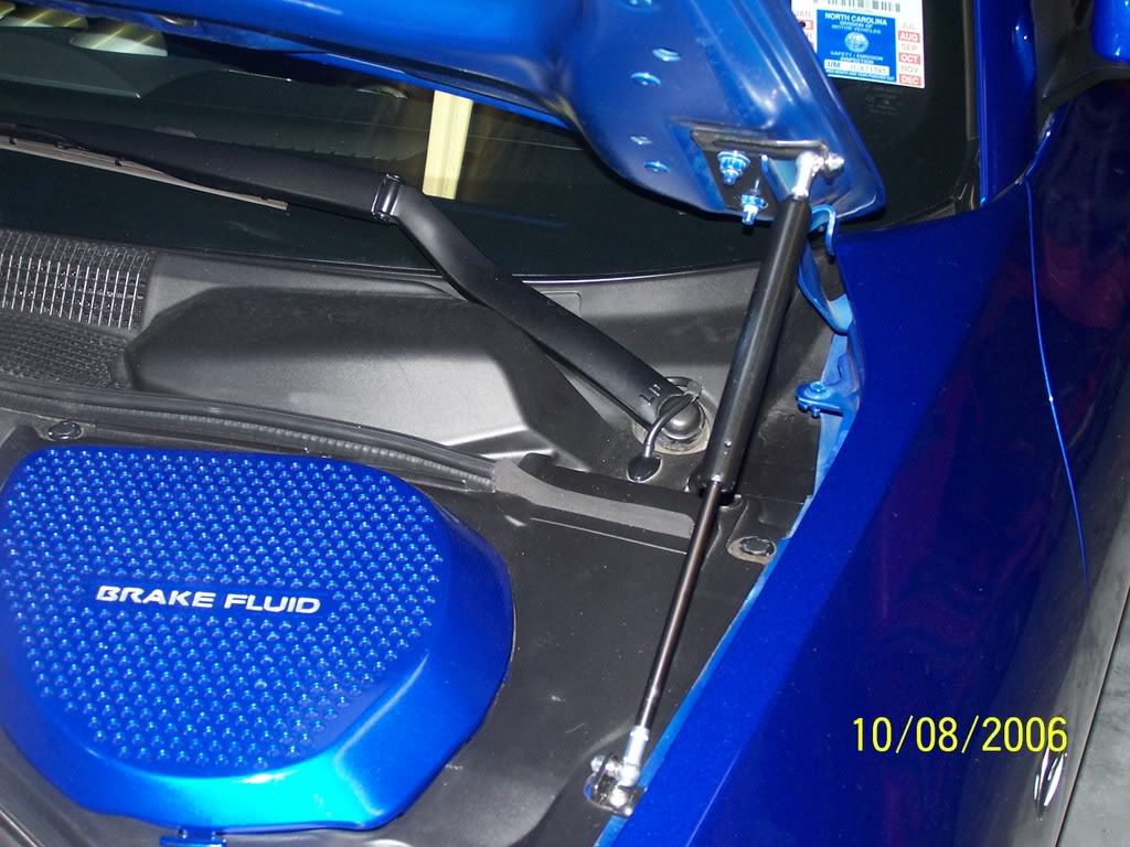

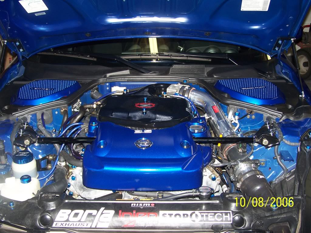

I saw that this thread had some activity again so I thought I would post some pictures of the CTD hood dampers that I have in case anyone is interested in them or seeing what they look like installed and the mounting points. Here you go.
The entire engine bay including the dampers.

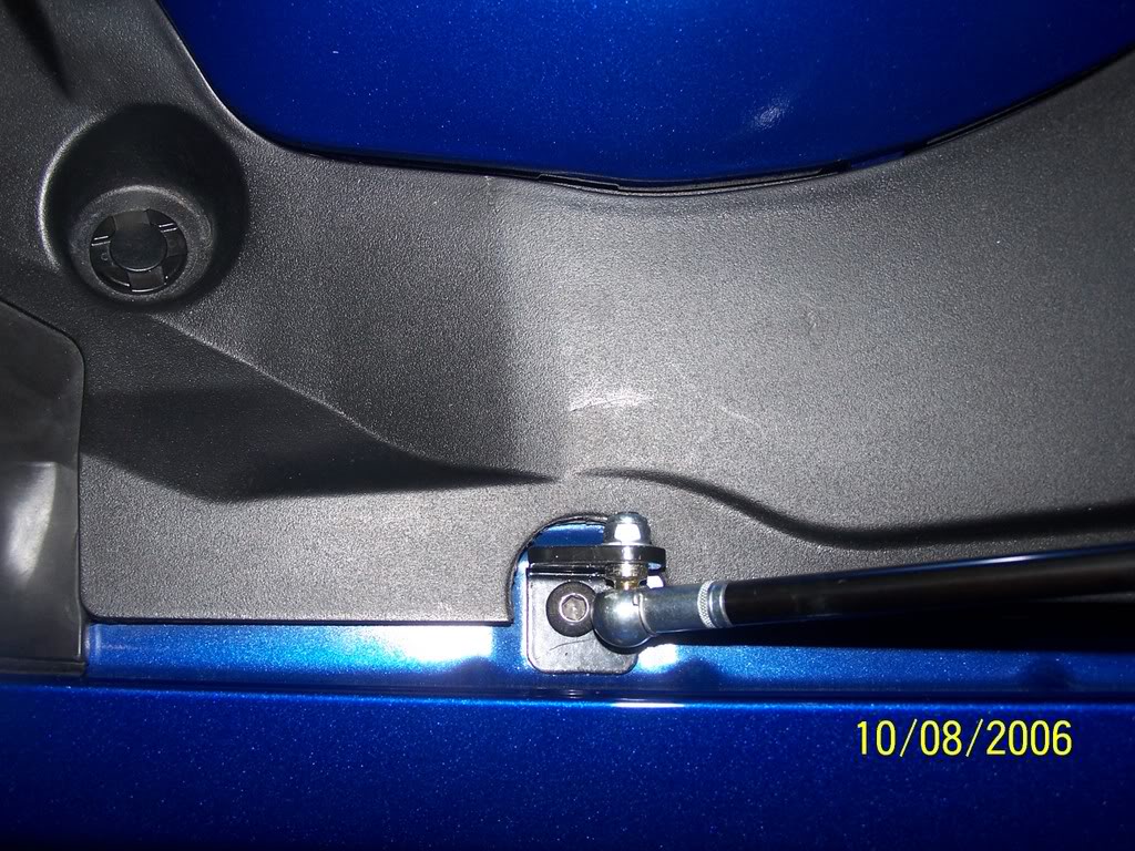

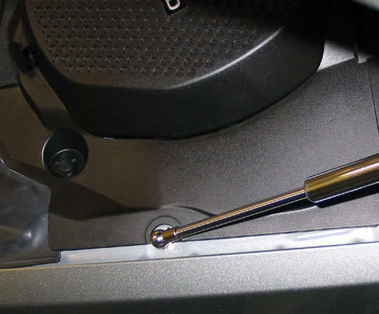

Lower mounting point and plastic piece that has to be trimmed.
Entire damper.
Hood (top) bracket.
The entire damper from another angle.

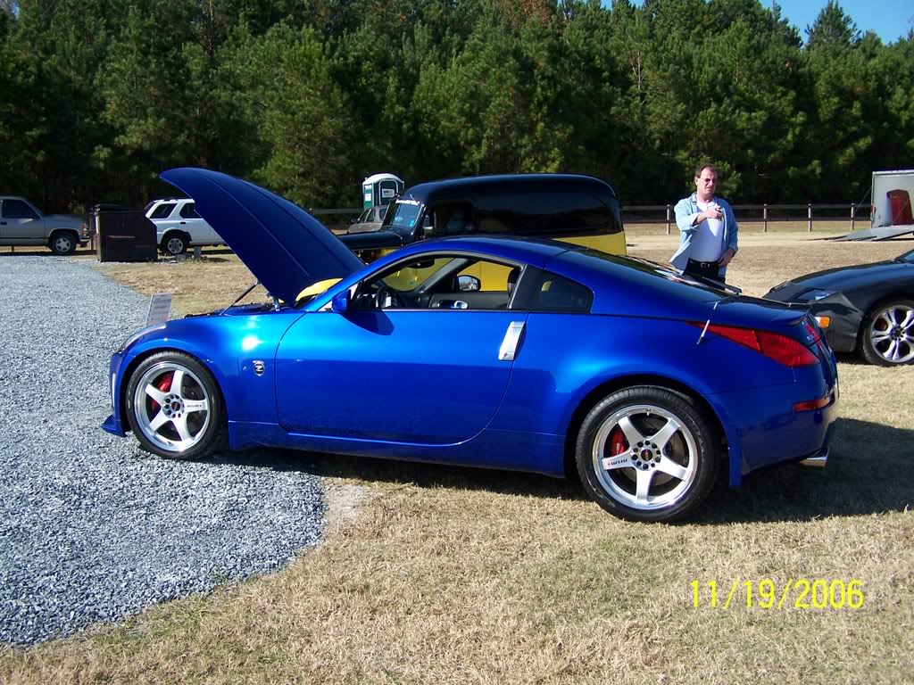

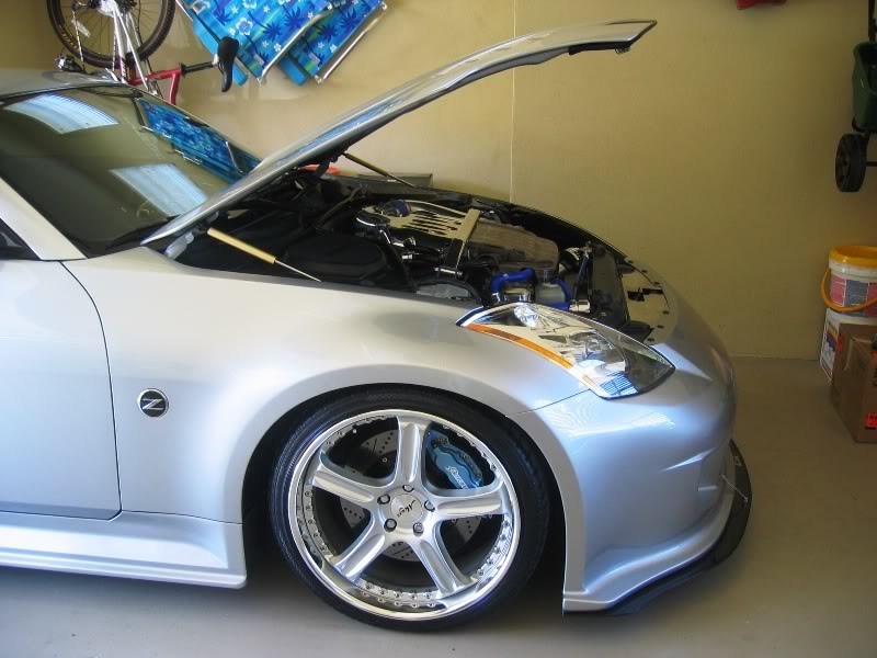

My hood now opens slightly higher than it does with the hood prop in place, but not that much higher. Here are the best two pics I could find. Neither are directly from the side. I'll try to take some more pics and post them later this week.

Here are two more picutures I found with side views. BTW I finally remembered how to post the pictures rather than a link to them.
Damn that is a good looking Z.
You can compare my hood in this one with hoods of other 350Zs with hood props. Sorry the picture was taken from the wrong angle and has shadows.
