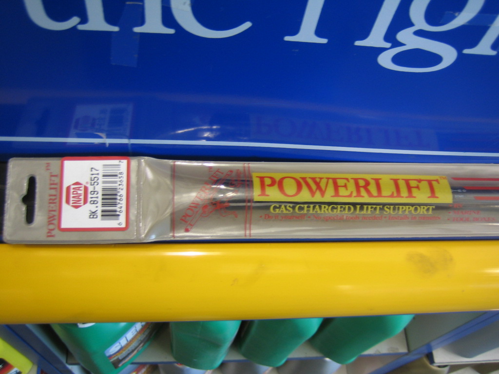

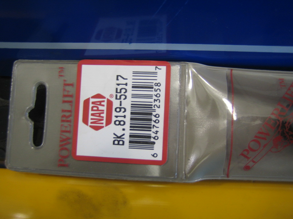

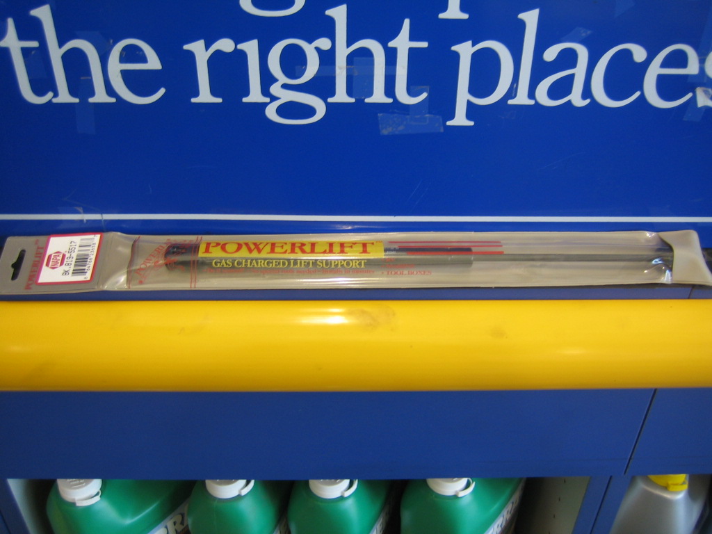

Default Napa Gas Props!

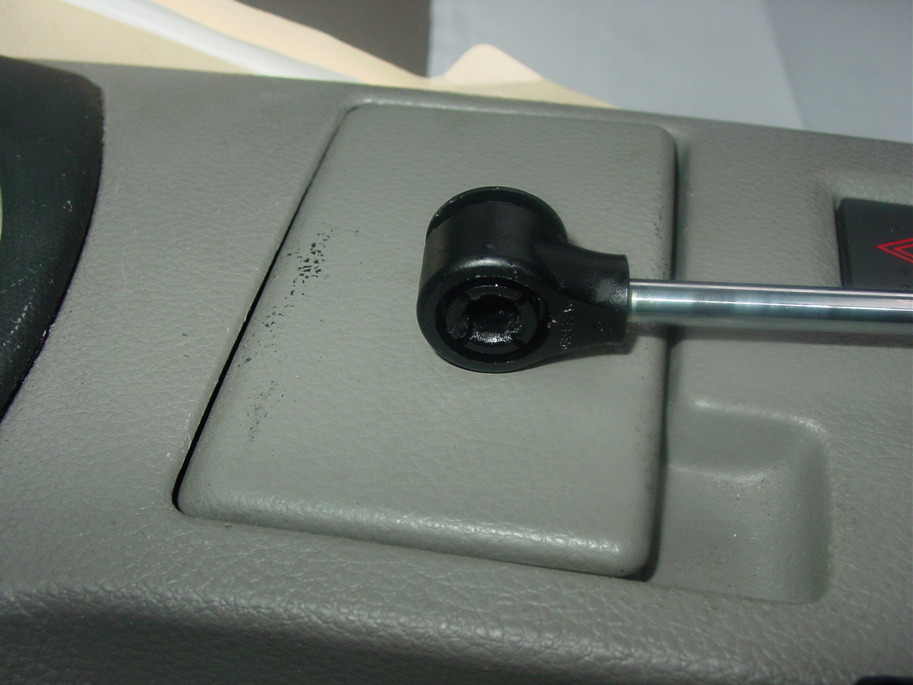

UPDATE: LIFT SUPPORT MODEL # BK.819-5517 60LB.
COST: My local NAPA $21.99 each.
These work beautiful! and yes the 60 lb are not too much.....reason being the have a much slower rate than my original 45lb suspa brands....
honestly.....im thinking of switching to these.
they have a much nicer look and are skinnier/slimmer...These are nice!
ill post more pics soon and installed pics soon!
-j

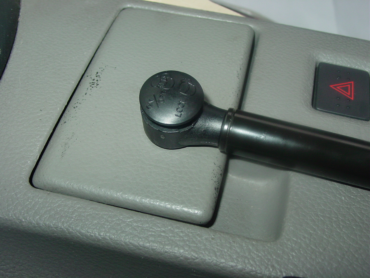

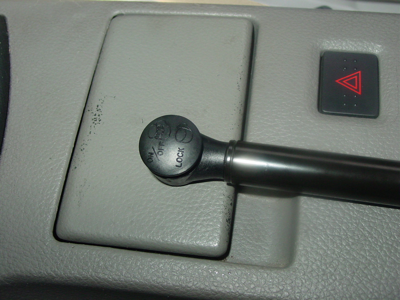

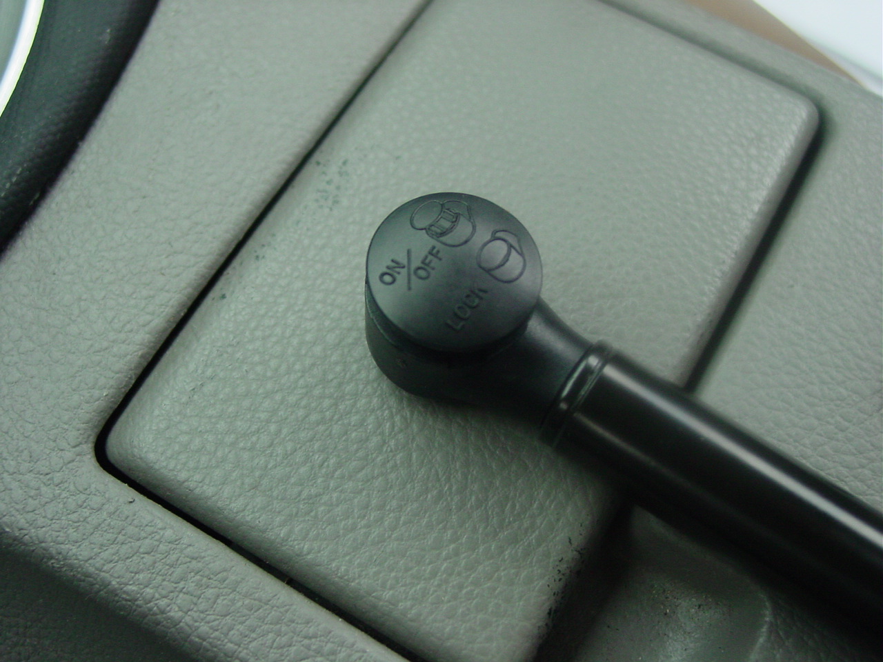

Default Napa Lift Supports
Napa Gas Props!
SEE ATTACHED PICS:
Okay guys, these are slightly different. For some reason my local NAPA autoparts store ordered the same model number (BK.819-5517) but the heads are round! not OVAL shapped like the ones weve been using so far. Either will work.
At this point it comes down to asthetics.
The NAPA told me there was no way of ordering and distiguishing between head sizes! so if you go in and get some, wait till they come in and check them out before you pay. They dont require payment to get them shipped from the warehouses.
Both Work really good! no clearance issues or anything!
- j
