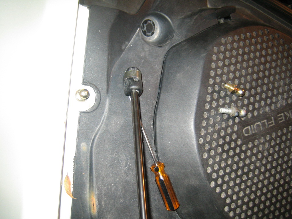

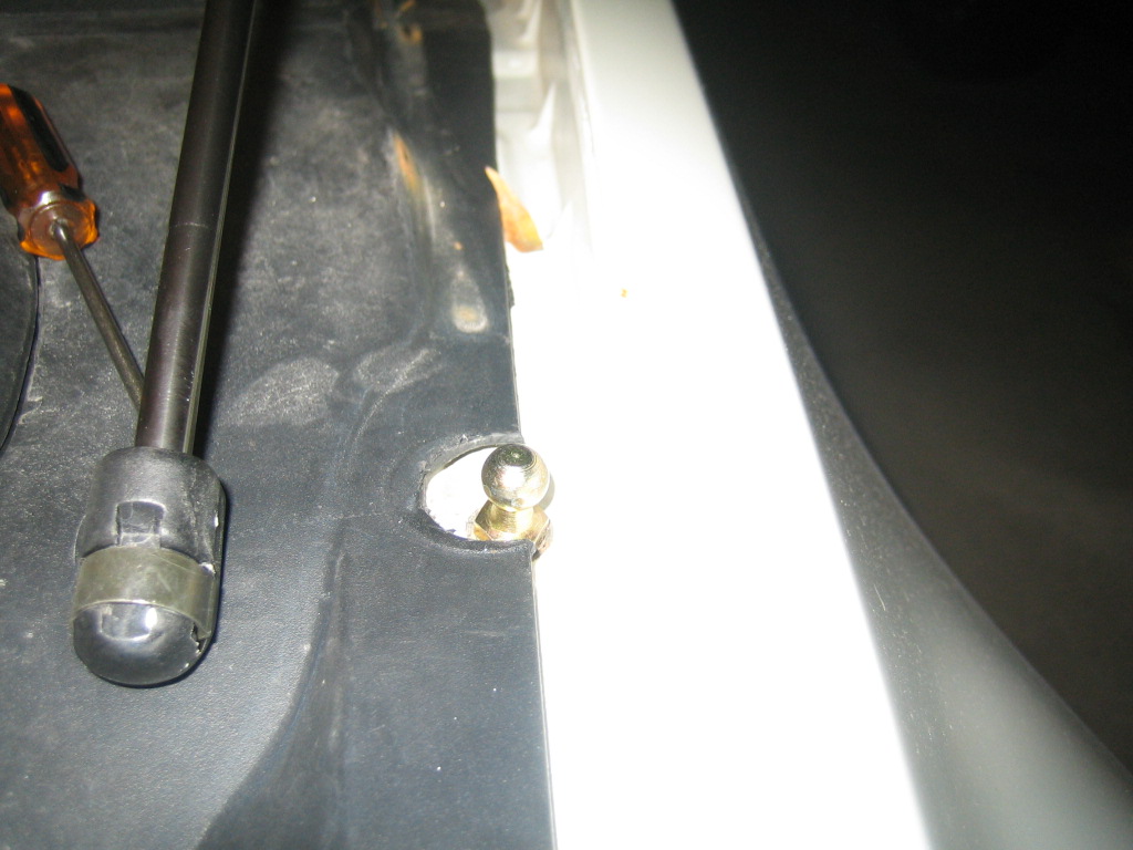

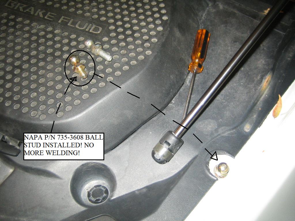

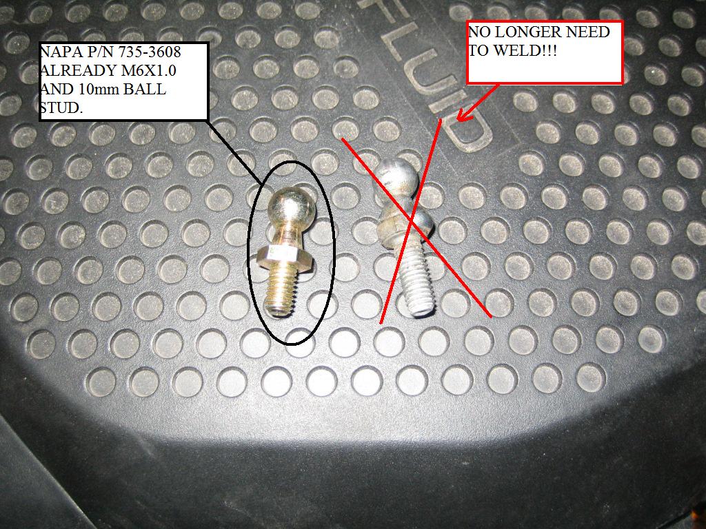

MEGA UPDATE!
THANKS TO ( buffmanjeff ) for his post 88. He found that NAPA sells the ball stud needed so that you DO NOT need to tap or weld...
This find makes this how too way easier to an already easy how to.
see attached pics.
1. Remember you only need two of the napa p/n 735-3608 ball studs per car. they mount on the fender factory bolt hole location. NAPA P/N 735-3608 COST 5.14 EACH!
2. You still need two NAPA part number: 735-1591 - 5/16 thread ball studs for the angle mounted on the hood. I doubt the p/n 735-3608 would be good to use for the hood location due to the size and short length of the shaft. you can torque down the 5/16th ones more. besides they are cheaper and easier to work with.
- Jason
