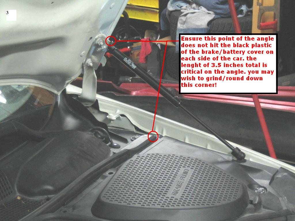

Actually. Your Best Bet Is Studying Post #9 Very Carefully.
Just Be Sure Your Angle Isnt Longer Than 3.5 Inches.
THE ALUMINUM IS CHEAP SO IF YOU MAKE ONE AND ITS NOT TO PAR? YOU CAN CUT YOURSELF ANOTHER PIECE. BUT WITH THE DIMENSIONS GIVEN AND CLOSE STUDY OF YOUR HOOD BOLT HOLES AND AREA OF INSTALLATION YOU CAN SEE IT MAKES SENSE QUITE EASILY.
PM ME IF YOU NEED MORE HELP AND I CAN GIVE YOU MY CELL.
-j

trust me you will do fine. just cut that aluminum piece and then use the holes on the hood to mark then drill the holes on your angle.
mount the angle by itself first and test the open and closing of the hood. make sure the corner of the angle does NOT touch the battery cover. if so then grind/round down the corner a bit.
it gets close!
its good to have someone help you open and close the hood while your peaking in from the side to ensure the angle doesn't hit the battery cover.
SEE ATTACHED!
- j

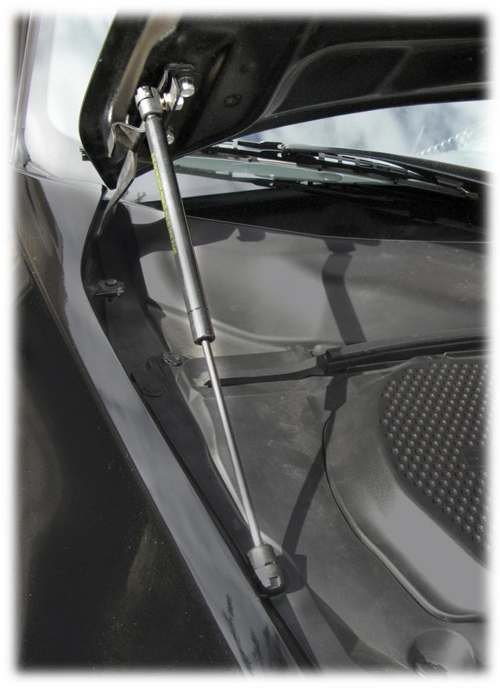

Old Jan 2, 2009 | 05:56 AM
  #109
fithamoto's Avatar
fithamoto
Sleeps in 350Z
iTrader: (24)
Posts: 5,745
From: Flower Mound , TX

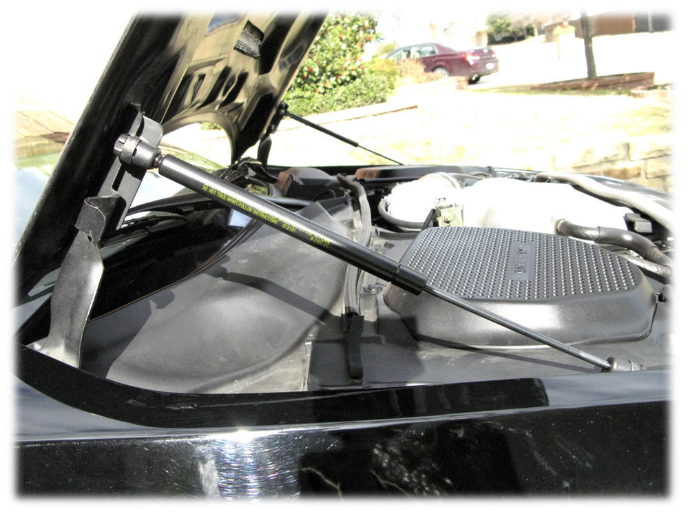

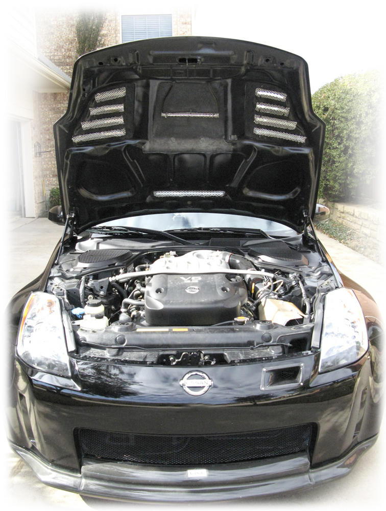

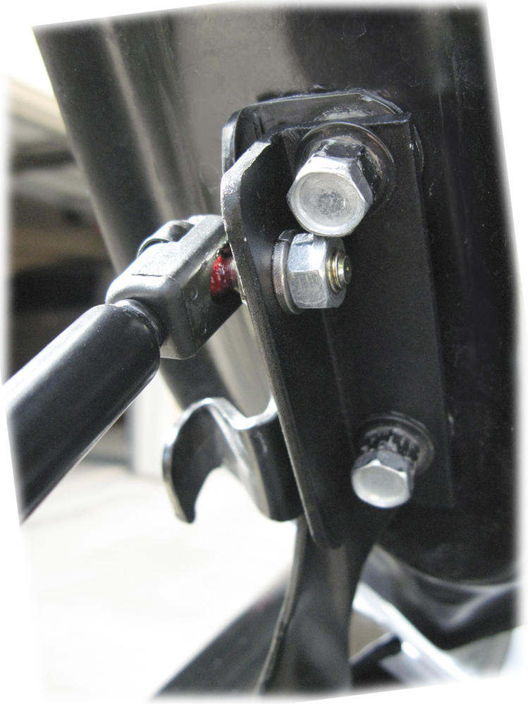

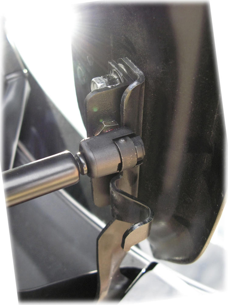

J,
Sorry to have taken sooo long to get some pictures up of the new shocks!
Jason's design was awesome and they work great.
Good job Jason.

Old Jan 4, 2009 | 09:19 PM
  #110
JasonZ-YA's Avatar
JasonZ-YA
iTrader: (60)
Posts: 11,204
Likes: 32
oh man, those are some money pics!!
yeah, guys, those shocks work great for carbon fiber hood............
-J
