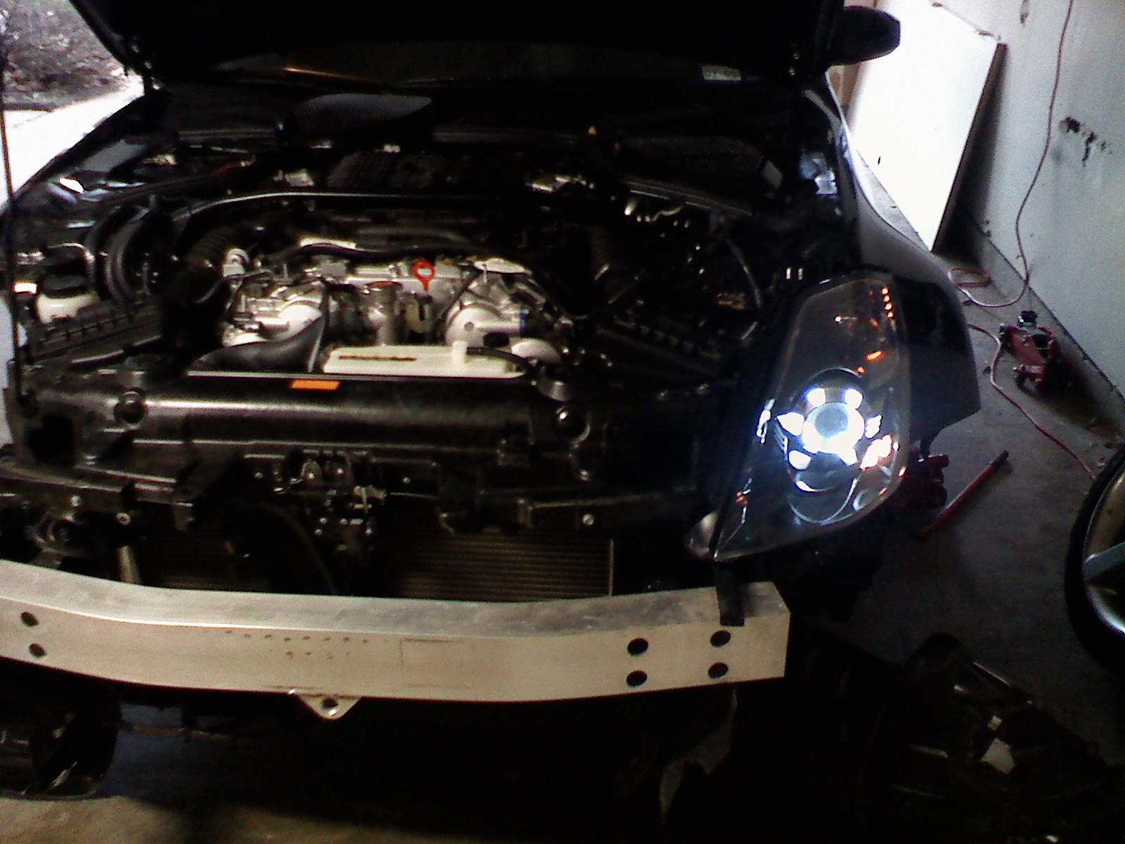

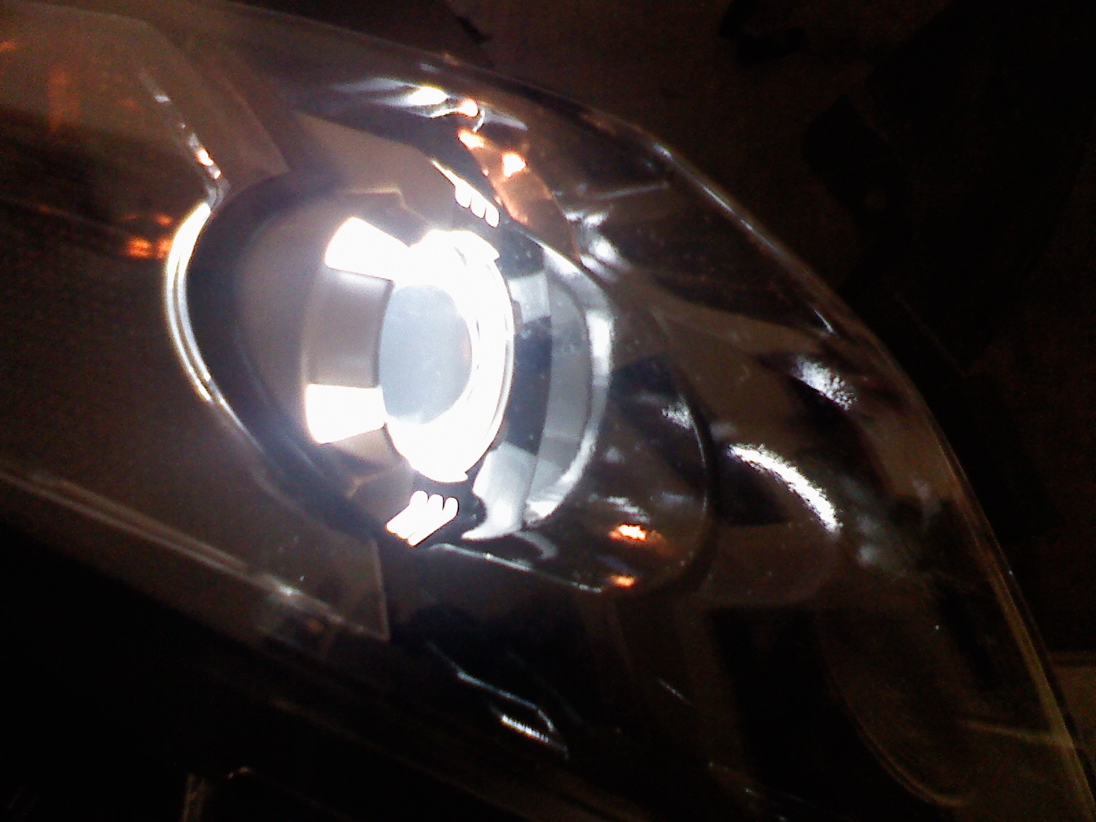

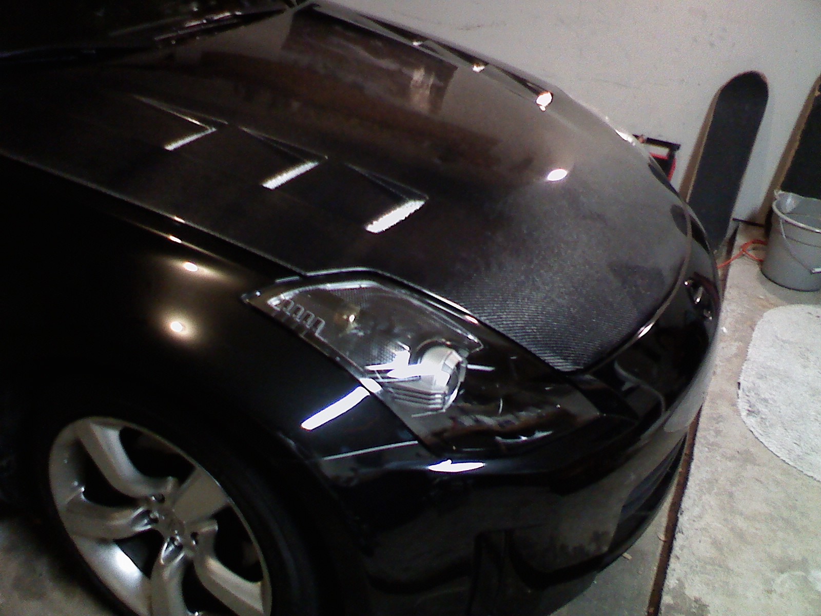

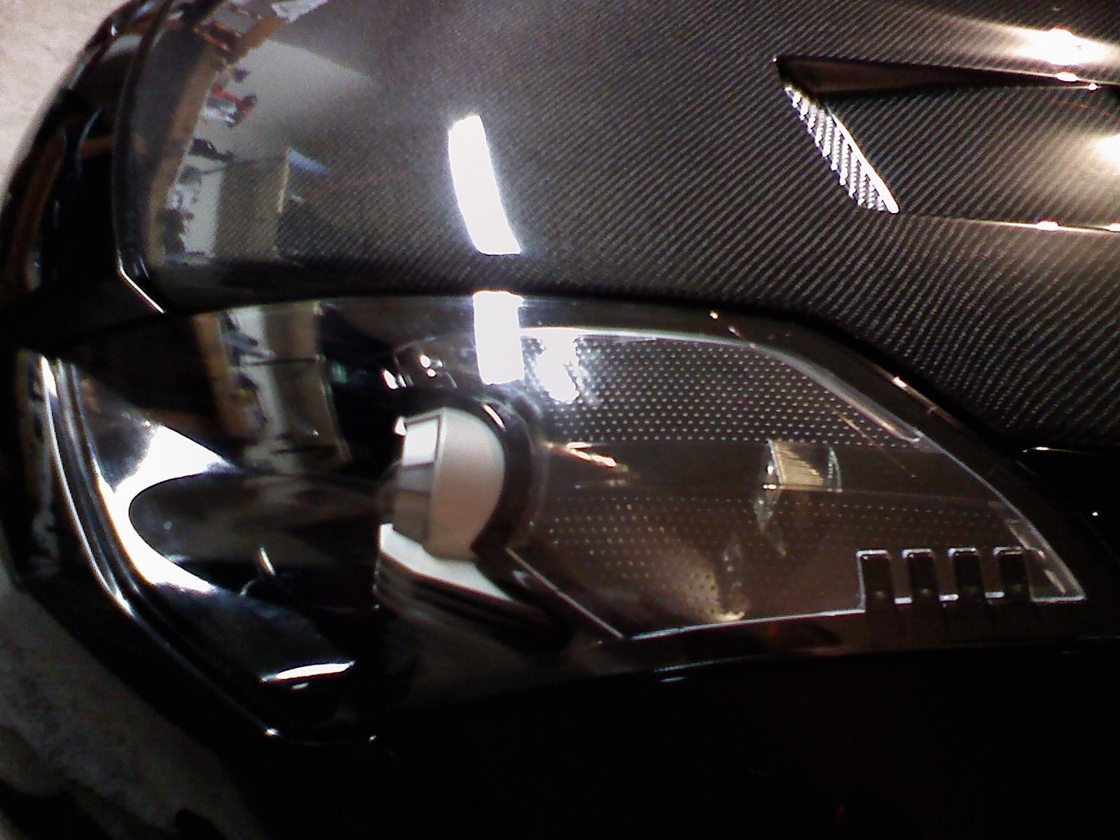

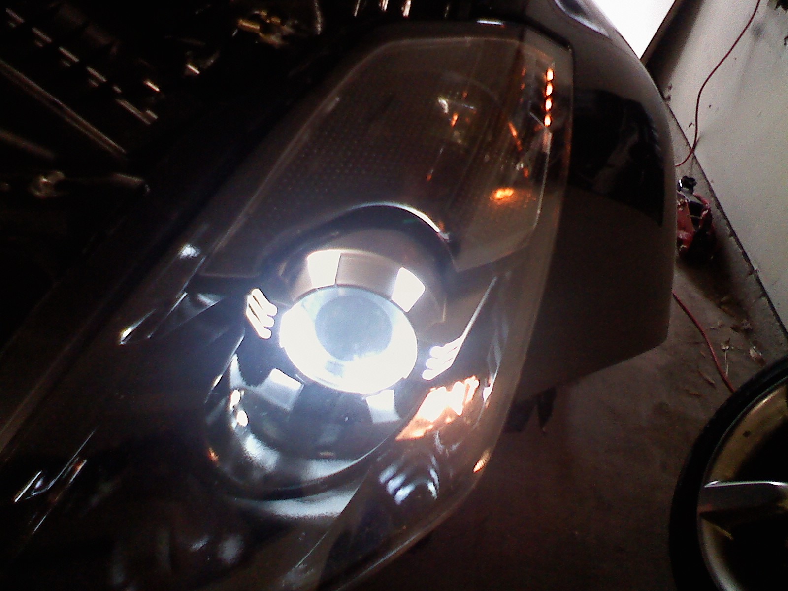

this helped out alot! thanks
Attached Thumbnails DIY: Black Housing-0313091734.jpg   DIY: Black Housing-0313091734a.jpg   DIY: Black Housing-0313091734b.jpg   DIY: Black Housing-0313092048.jpg   DIY: Black Housing-0313092049.jpg
