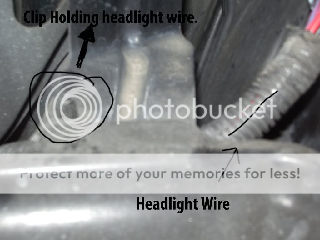

Im noticeing some people are having trouble getting the headligh tunpluged. I recently did this and found a easier way to do it. The left headlight (battery side) is pretty easy to get a flat head screw driver to to push in the little button that releases it because the cable is long enough for you to pull the head light out and get to the plug. The right side on the other hand has almost no slack to it and you cant get anything (srcewdriver) to it. There is a solution to that, here it is http://i318.photobucket.com/albums/m...htwirecopy.jpg. Once you pop out that little plastic guy it will give you more than enough slack to easily get at the plug. I hope this helps someone.
