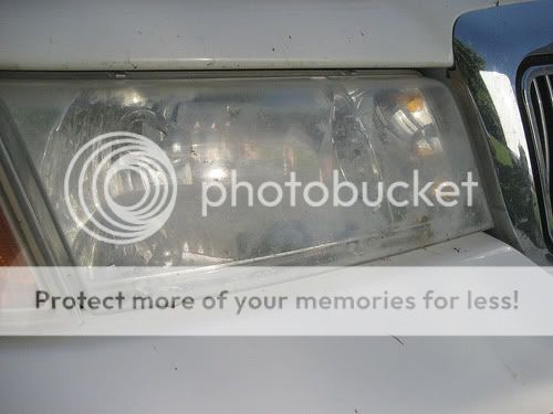

Before Pix:
After Pix:

Before Pix:
After Pix:
