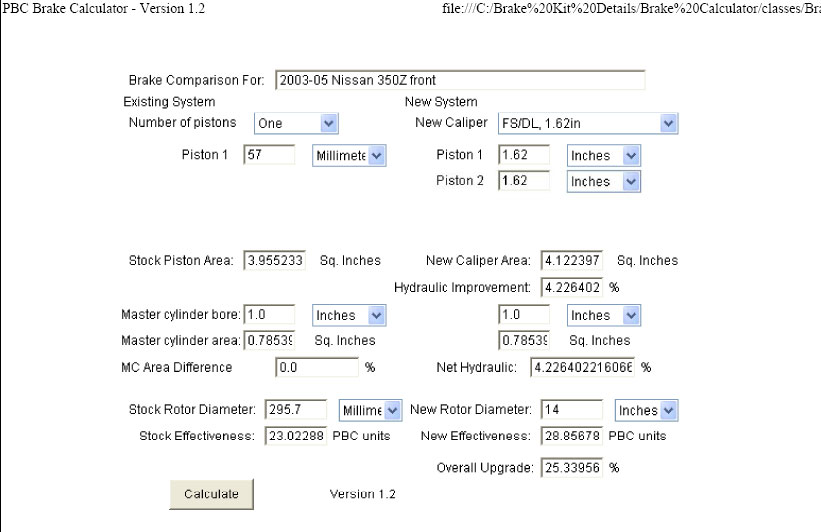

Besides the difference in rotor annulus, requiring a different cut on the calipers to fit over the larger diameter rotor, you also need to consider piston sizing. The key equation to consider is the brake torque equation:
Brake Torque = Effective Radius * Clamping Force * Pad Cf
Effective Radius is approximated by the distance from the center of the hub to the center of the pad. It describes the "lever arm" of your brake system and is analogous to the length of the handle on a torque wrench. Double the length of the handle and you can cut the amount of force applied to the wrench to get the same torque.
Clamping Force equals hydraulic pressure * total effective caliper piston area. As you increase the size of the caliper pistons, you increase the clamping force.
Pad Cf is simply the coefficient of fiction of the pad at the temperature you are considering for testing. Remember, pad Cf is not a single number, but changes with temperature.
You can make several simplifying assumptions that clean things up a bit. Assume the pad Cf is constant, since you'll likely be picking the same pad compound for the 13" or the 14" kits and you can assume a temperature well within the flat part of the Cf vs temperaure curve. Assume you won't be changing the master cylinder, so the hydraulic pressure remains constant relative to the brake torque at the rear brakes.
As a result of these assumptions, you can use a spreadsheet to determine what the caliper piston size should be when moving up from 13" to 14" rotors in order to avoid changing the bias of the brakes.
You should do the same with the 13" kit by starting with the stock, 1-piston floating calipers and calculating what piston sizes you should use for a 13" 4-piston system. But you need to remember to multiply the stock piston area by two to calculate "effective area" for a 1-piston sliding caliper. I've seen people forget this and end up with a front brake kit that has only half the required brake torque with the resulting huge rear bias and dangerous instability.

Thanks for the info DZeckhausen. I've been using comparisons of components offered by other BBK builders so far...
As far as the timeframe goes, I'm thinking I'll have my vehicle fitted sometime after Christmas... probably the beginning of January. Testing by zillinois will most likely be later than that because of his schedule... but at least I'll be able to report how my impressions are going from the stock non-brembos. I'll be doing my testing, hopefully, down at SIR in Kent... Once I have the fitment done on the brackets, I'll post what I've done on my vehicle and if others are in a position to test the set-up then they can report any findings as well.
Attached is a printout from PBC Brake calculator... I'm trying to stay within known combinations from other BBK builders.
