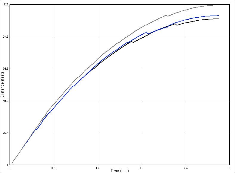

Since there's kind of a lull in the action, I thought it would be good to get some input on the brake comparison.
Should I use the stock pads or Hawk HPS? I'm not sure what kind of pads we will have for the Wilwoods, but it might be hard to control for pad variability. Any input?
My plan was to to some classic 60-0 braking runs and also to do some 120-60 or 100-60 runs. I think the 100-60 is a better test of the brakes for racing applications because this is a typical braking scenario on the track. I'm very interested in these times and distances, because I always find it hard to believe that big brake upgrade rarely reduces stopping distances. I think the BBK is not in its efficiency range at slower speeds and that's why distances are not reduced much. My prediction is that the 120-60 or 100-60 will be reduced substanially with a BBK over stock. This is sort of based on a seat of the pants dyno from my on track experience. Any other tests you want to see?
I've got a non-contact IR thermometer to get rotor temps and a datalogger which has a physcial wheel speed sensor so the data I get is quite accurate. But I was wondering what temp I should bring the rotors up to before beginning the tests.
I got my data logger installed last night and did some inpromptu practice runs to get used to the system.
Three 60-0 mph runs yielded: 108 ,113, 123 feet.
Attached Thumbnails DIY Assemble your own Big Brake Kits: Caliper Brackets (Custom)-braking.jpg
