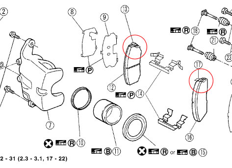

the metal things the tech was talking about is this: (see attached photo/circled in red) and those are wear sensors. and having 2 instead of 4 is good enough because if they do start to make contact due to brakepad wear, then its time to change all the pads.
toothlessracer: the sound you hear on low speeds is normal due to the pieces of metal contained in the brake pads. metal pieces contacting a metal rotor will produce sound.
