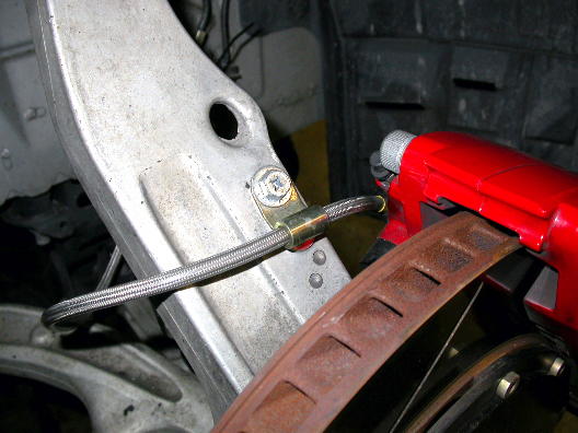

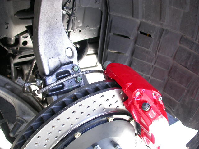

StopTech does provide a bracket on the line to establish proper routing.
The line locating bracket can be used in 2 different locations as the stock lines are different for the Track (Brembo calipers) and non-Track models (standard slider calipers). On the non-Track model, there is a sheet metal bracket attached to the aluminum strut. After removing the stock line, we retain the sheet metal bracket and the line locating bracket attaches to the aft facing stud as shown in the first image:
On the Track model, the same line locating bracket is attached to one of the holes used to mount the sheet metal bracket used with the non-Track model calipers: https://my350z.com/forum/attachment....1&d=1145400312
We have a manual for installing the 350Z front lines, here is a link: http://8.7.96.35/tech_info/manuals_b...A_10-25-04.pdf
We have sold hundreds of line kits for all configurations of the 350Z including our big brake upgrades. We have never had any issues as long as the lines were properly routed.
If any of the above is unclear, please feel free to contact me directly, I'm always available to answer any questions.
Matt Weiss
StopTech Tech Support

I am not talking about those attach points, but the strut attachment point on the front lines, that is convieniently ignored. I find that the lines are very close to the strut and could come in contact with the strut if the wheel is turned all the way.
This issue should have been addressed while the lines were designed. It would definitely help if someone at StopTech could explain why stock routing was changed and what were the advantages of that.

You do realize that for Brembo alternate routing in the manual you have the line routed above the bolt, and in the pic attached you have it going the other way (line below the bolt). I installed your SS lines this past weekend and was fiddling with both methods. It seems that the one indicated in the manual (line above the bolt) yielded the least rubbing at full lock, but honestly it is still somewhat concerning. The only mitigating factor could be that with the suspension compressed (not on jack stands), this adds some additional slack in the line which will prevent the rubbing. Not trying to b*tch, just pointing it out...they are great lines and all hardware used is top notch.
