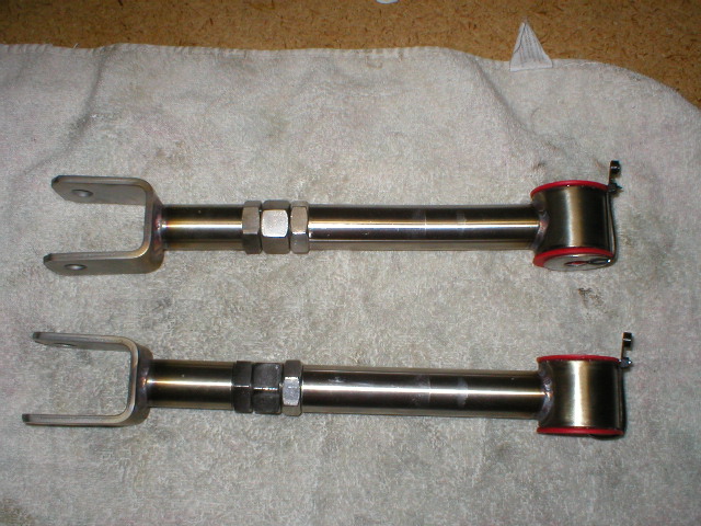

I received my cambers rods yesterday and will install them Saturday and take pics. Unfortuantely it looks like I'm missing 2 washers. I believe each rod should have 2. I've emailed them and hope to get an answer. The local hardware store doesn't have the correct size.

There is supposed to be a 1.5" OD x .5" ID washer on each side of the bushing and is to be placed between the bushing and suspension mounting. This is for the camber rods only!
One of my rods didn't have washers but I finally found some at a hardware store.

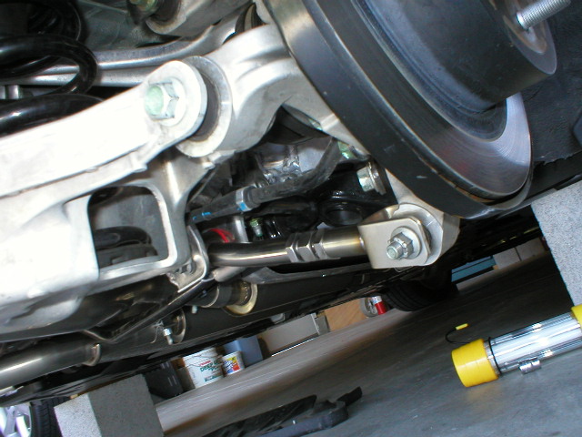

Camber rods installed Saturday. Easy project. Really nice product. Can't beat the price either.

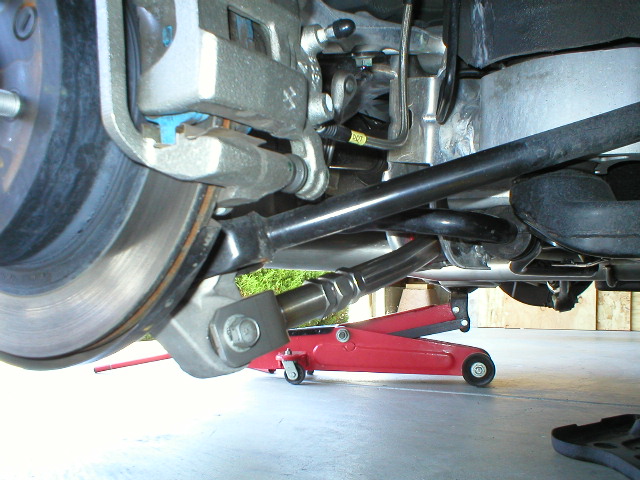

Another pic from the back side

Installed my camber and traction rods on Saturday. I aligned the car shortly after to bring the camber back to -1.9 in the rear and -1.3 in the front. I want to thank LSDunique for making such a high quality product for 1/2 the price of JIC. The car handles great and really feels a lot stiffer on corners. Definately recommend these rods if anyone needs them.

Just installed mine today as well. The camber kits are top notch! good job!
Went to get alignment, the rear were -2.5 before the camber kit, now it's -1.9, which is the close to the maximum factory spec. I have Eibach Pro-Kit as well.
Note- The factory camber rod is very tight! you will have to use some muscle, but it will come off. Also, it's best to remove the lower bolt first, then twist the rod a little to remove the upper bolt, since it's hitting the sway bar. The bolt looks like it's not coming off, but it will, after you twist the camber rod a little. Very tricky, imo..
