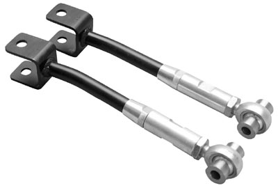

Default HERE's what the STILLEN pieces look like
These are the STILLEN units with the rod ends. I don't know if they use Aurora or National... might call and ask. . .

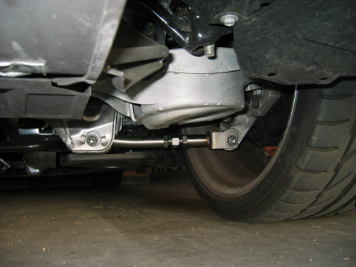

Got my camber bars, and they work flawlessly. Went to get my car aligned and wanted my camber at -1.3. The rights rear was able to achieve this, but my left rear was not able to get to -1.3 without serous toe'ing. I had to settle with -1.9 with the toe still out of factory spec on the left rear. Will the traction bar fix this problem? I'm confused where the traction bar is, do you have picture of it's location? Maybe the G35 coupe traction bar is different. From my knowledge (limited) the adjustment to the toe is near bottom spring housing. I have nothing that looks like the traction bar near there.
Here is a pick with camber bar installed. Nice work LSD!!

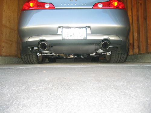

Another
Attached Thumbnails developing camber and traction rods for rear, any interest?-116081-bar.jpg

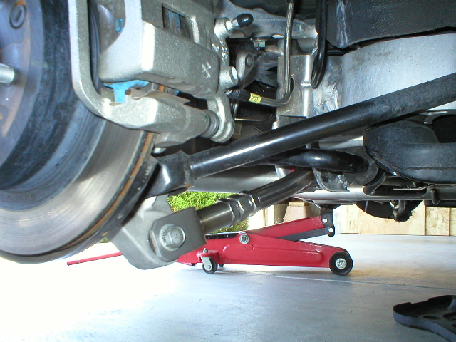

Here's a pic of the stock traction rod (black one in front) with the LSD camber rod on the 350Z.
Attached Thumbnails developing camber and traction rods for rear, any interest?-new-camber-rod-1.jpg
