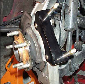

The picture posted by black07nismo earlier in this thread is exactly what I have on my car. If you can visualize it from his picture, the bracket is at a slight angle, and the bolts go directly through the caliper from what looks like about a 15 degree angle:
In other words, looking at the above picture there's an allen bolt that goes from right to left through the caliper into the mounting bracket. I can't quite remember exactly what the bracket looked like, but it was basically an "L-shaped" piece just like this: (pic taken from a different car)
Hope this helps.
Javier

Here's a better picture of what the bracket positioning looks like on a Z.
Javier

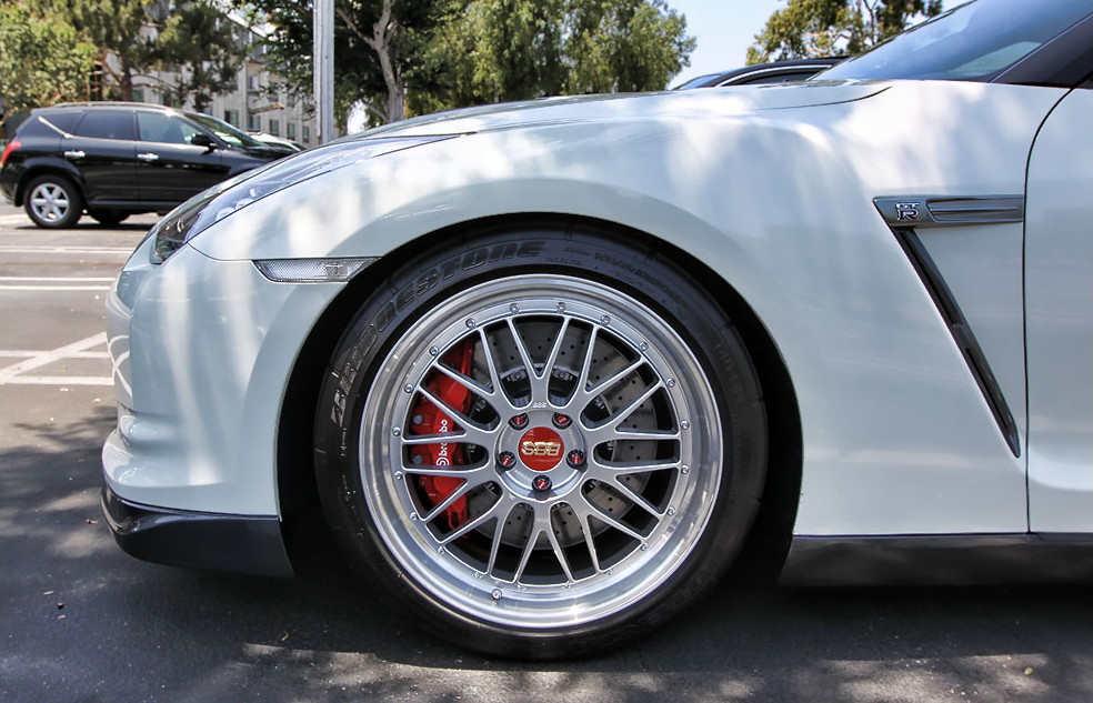

This is still alive - Working on fabbing a front bracket, month 4
..... So red or brembo gold???

Old Sep 14, 2009 | 12:35 PM
  #198
Done Deal DR's Avatar
Done Deal DR
Posts: 5,777
From: Phoenix, AZ
My votes for red. Should go with your color and TE's very well...
