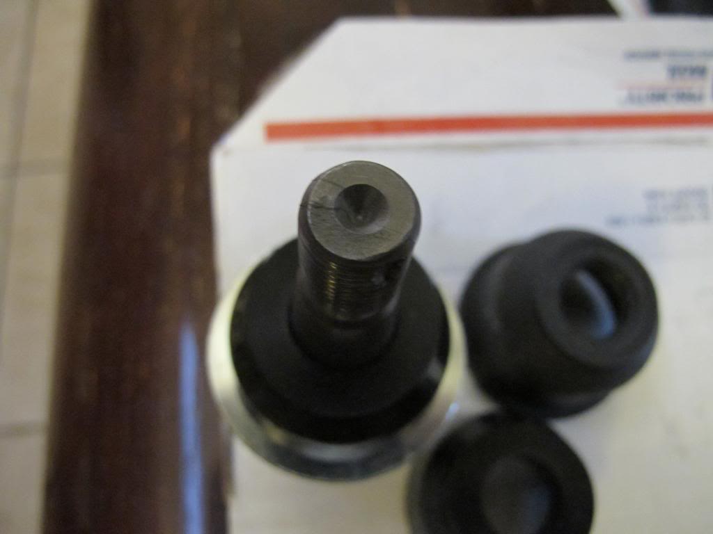

Boots from Diverse came.They fit eBay ball joints well.
I'll post how they go on the oem units.
This just came.
I plan to do it today or tomorrow.
