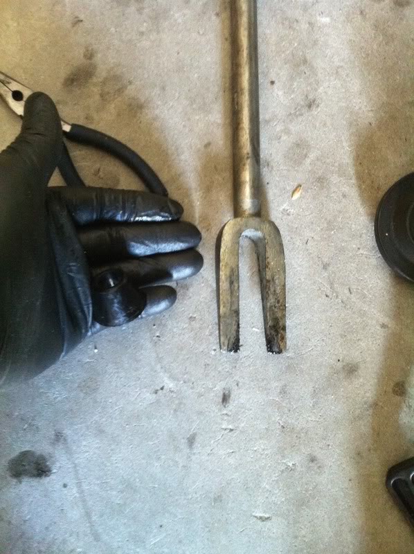

Thanks. I'm actually going to take the knucke to a shop so they can press out the old one and press the new one. I just gave up with the autozone press after 1hr of trying.
Also do I need the cone? It's a pita to remove.

I did it with the AZ rental tool fairly quickly. You just need to make sure you get the proper order of the press tools.
And yes, you NEED that cone. Without it, you won't be able to install it properly.

use that tool. you hammer the end and it pops the cone off

called separator fork
Picklefork.2.
