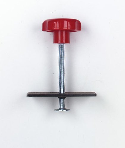

I bought this guy from sears and its super easy and was about 10 bucks:
http://www.sears.com/shc/s/p_10153_1...d=brake+piston

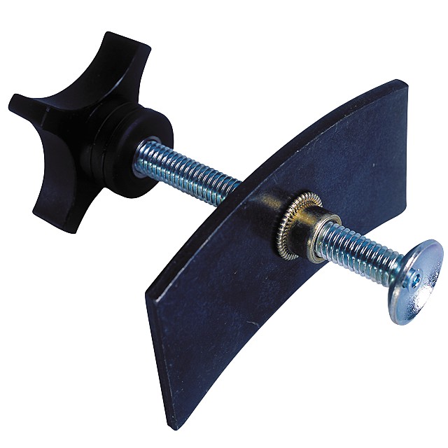

Yeah, just as Dave said press it back to the housing. When you first press the brake it will re-adjust to the positionit needs to be. One thin gto note becareful with the clamp on the caliper. I don't think you hurt it but remember its only a casted piece of aluminum that will break if too much pressure is used.
Something like this is more user friendly... and reletively low cost.
