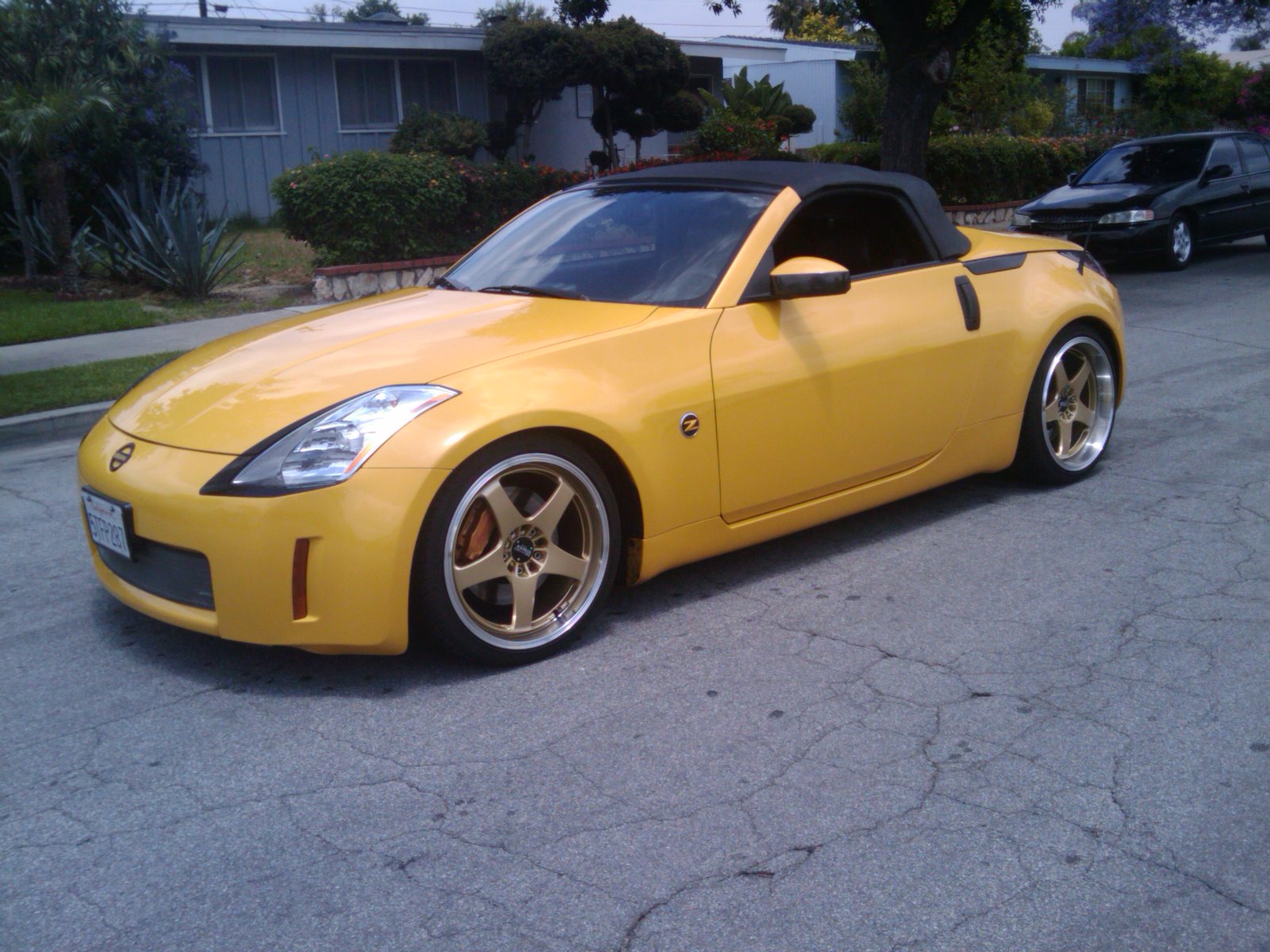

Hey guys im looking into to lowering my Z but I have couple question not sure what brand of spring I want to buy but Im looking for 1 to 1.5 drop. Also if you can chimein with con/pros about buying used springs that were use for the track is this a good idea or not? am looking to spend no more than 250 money is tight right now
I have 19x 8.5 and 19x9.5 245 and 275. Thanx I'll apreciate your feedback!
