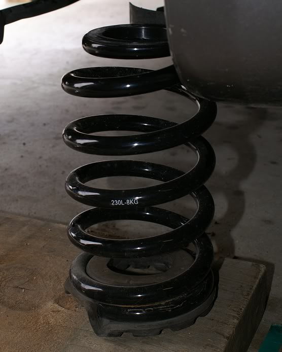

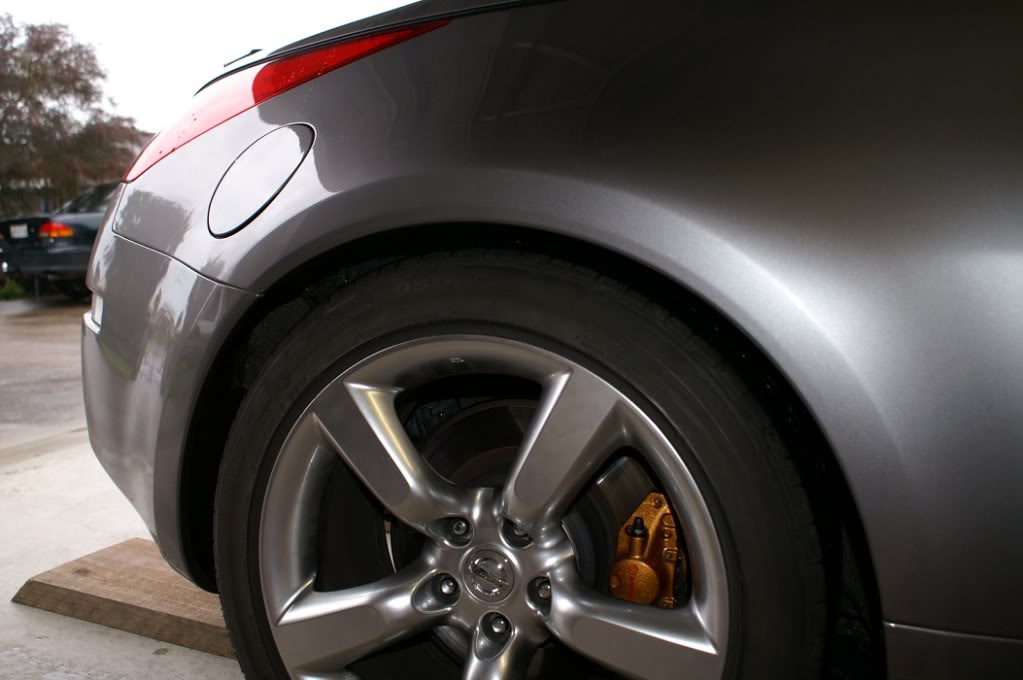

I specifically asked for the standard rear springs when I got mine a few months ago.
From ground to wheel arch on stock springs was 705mm rear and 680mm front. On the BC Racing coilovers I now have 680mm rear and 655mm front. Still plenty of adjustment up/down left. I have 20mm bolt on spacers on the rear and 15mm bolt on spacers on the front.
With the mild drop and spacer the rear camber blew out to -2.9° so now I have maxed out the stock adjustment and got it back to -1.8° (each side)
Doing this resulted in a lot of toe in which I have adjusted back to ~2mm toe in (total). Think perhaps I should reduce this more. Comments?
Front camber has ended up at -1.4°

What does your rear spring have stamped on it? Standard spring should be 230L-8KG.

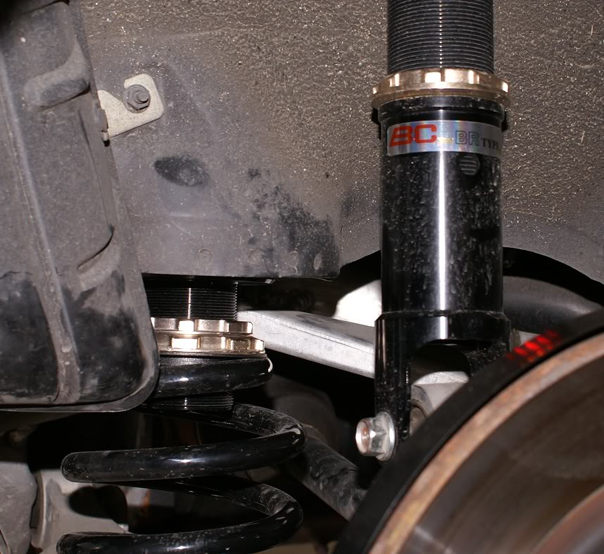

Okay here are some pictures I managed to take.
Spring number on the side is 62 97 210 008
Notice I have mine adjusted to the max I can go
This is high as it will allow me to go.

Upon looking at the pictures I can see that my spring looks fat and short vs the others that look much taller and slimmer. lol
