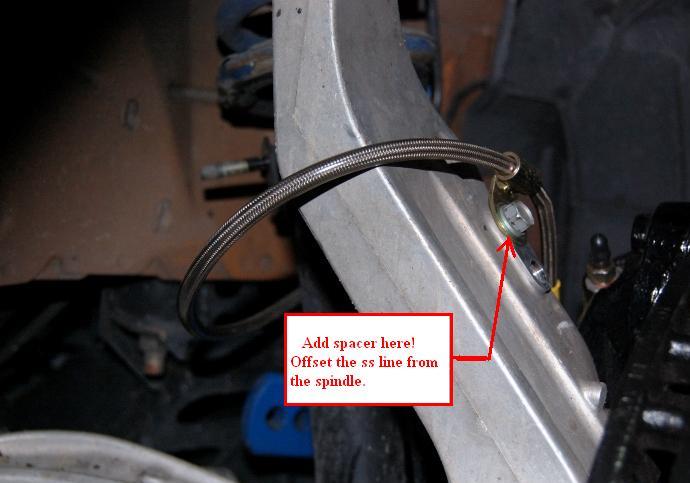

I may also say that you may want to add a spacer and use a longer bolt...ive found that to help it make the 180 degree turn around the spindle...
See here:
https://my350z.com/forum/8916893-post85.html
Originally Posted by JasonZ-YA
I have found that adding a spacer and using a longer bolt really helps the ss line with bango bolt that is configured 90 degrees from mount location to work well.
Add a spacer like this:
Like shown here:
it really helps the ss line make the 180 degree turn back around the front spindle.
Bolt is M8x1.25 - length dependant of spacer used.
-J
You may not need the spacer as you have the line wrapped already anyways...just FYI...
-J
