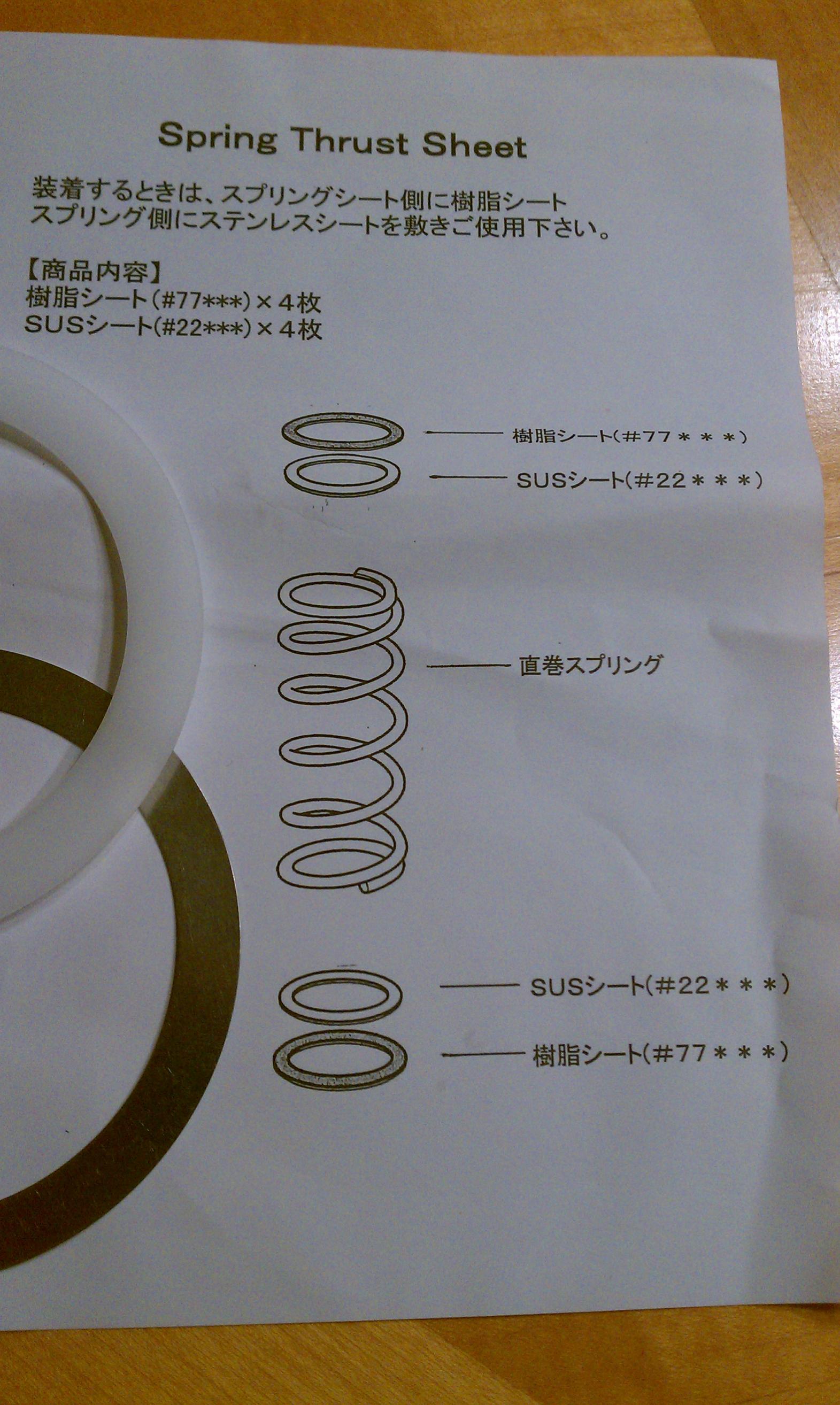

Well who can read japanese? I'm about to install the SPL thrust washers and cannnot read the direction. I just need to know if the metal washer or the teflon washer rides against the spring. http://splparts.com/store/product-info.php?pid128.html slightly disapointed in them (its a Swift product sold by SPL) , i was expecting an actual bearing plate like http://compare.ebay.com/like/1304881...=263602_304662 but these will work. Just need to order another set with my next order from SPL.

The "RESIN" one is that one that does not contact the spring.

I just got a set of these.
I'm guessing that it goes
silver
white
spring
white
silver
Am I correct?
Old Apr 7, 2011 | 01:47 PM
terrasmak's Avatar
terrasmak
Super Moderator
Posts: 29,119
Likes: 2,400
From: Sin City
White
Silver
Spring
silver
white
They quiet down the spring a bit, and make it easier to add preload.

The instructions are a little misleading. Thanks
