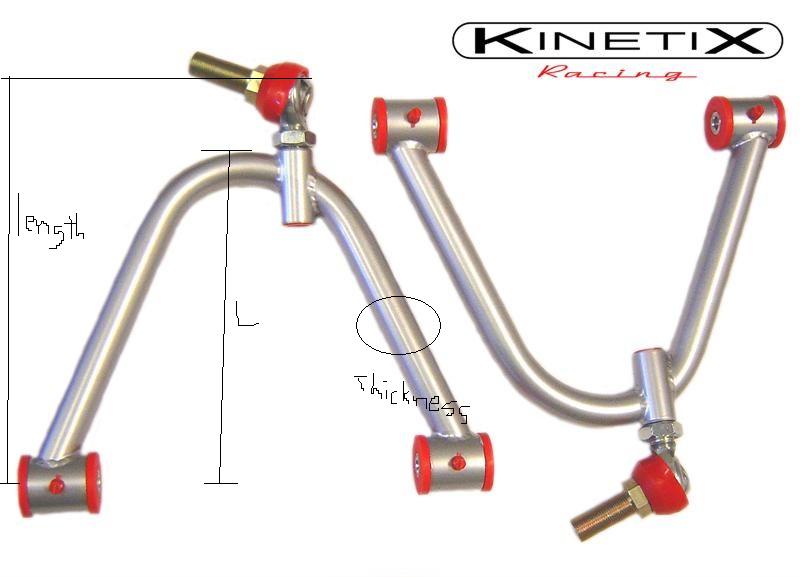

Thanks for stepping up.
Could you get the measurements that i showed in the pic?
If you ever seen stock arms, how do they compare in thickness?

L: about 8.5" from the center of the bushings like you drew, 9.25" if you go to the bottom of the bushing
length: 11" from center of bushings, 11.75" from the end
thickness: diameter is right at 1"
I realized that my camera ended up in my brothers pocket and went home with him after the autocross last weekend. I probably won't be able to take any pics until next weekend, but I'll try to remember to take a pic of the Kinetix arms up next to the stock arms on the car.

EDIT: the main thing i want to see in the pic is thickness and design comparison
