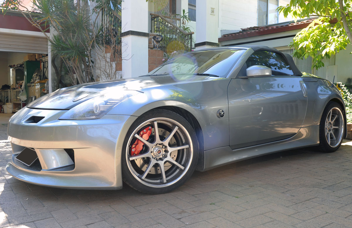

I offer the full line of Wilwood kits and product as well as my own spin on this popular kit; a W6A caliper shod version of the 14" front kit. Achieved by removing the BSL6 and replacing it with the newer and larger W6A and pads I then substitute the TCE radial mount bracket for mounting it. The W6A however due to size will require roughly 3/16" more spoke clearance than that of the BSL6. (making it an unlikely fit on SSRs above as I think they'd be just to tight to that inner radius)

I believe this was one of the first ones I did. Don't recall the Gents name but he's in Australia.
