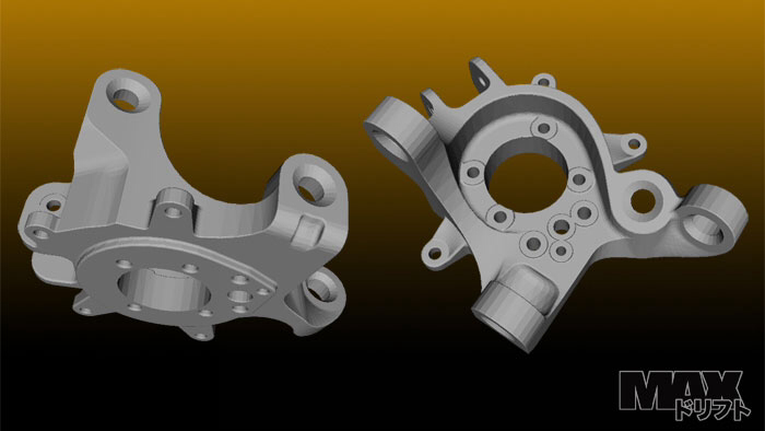

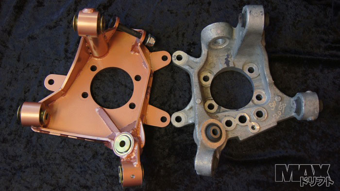

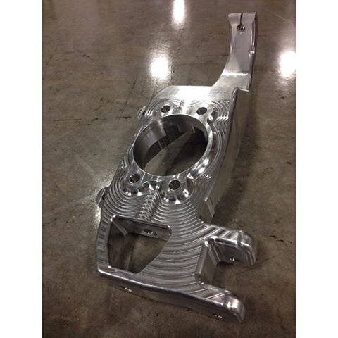

I've been searching for drop knuckles and look like I've found something ... I know the front knuckle is for the 370z but it's possible that they will make on for the 350z and the rear knuckle from what it sounds like could be finished soon
http://www.partsshopmax.com/e107_plu...opic.php?10886
http://www.the370z.com/track-autocro...p-knuckle.html

Any what exactly is a "drop knuckle" and features/benefits?

It's a knuckle assembly that relocated the joing/bushing points, so that the wheel bearing effectively sits higher up in the knuckle making the car lower without making any changes to the spring length or shock travel. This effectively means you have just lowered the car without making ANY changes in the geometry other than the ones you wanted to, say for example to adjust the roll center. It's the correct way to lower a car and if designed correctly for the right geometry and combination of drop and roll center adjustment it can make a very positive change in the car's suspension.

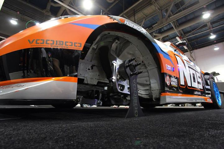

I emailed voodoo13 and I asked the if they will be making front and rear drop knuckles for the 350z and THEY SAID YES ! Expected to be released in March of this year ... Didn't ask about price ... Most likely expensive ... Check them out on Facebook ... The web site isn't up yet
My thoughts:
That makes perfect sense, that's actually a pretty good invention so now I know why you guy are poppin
