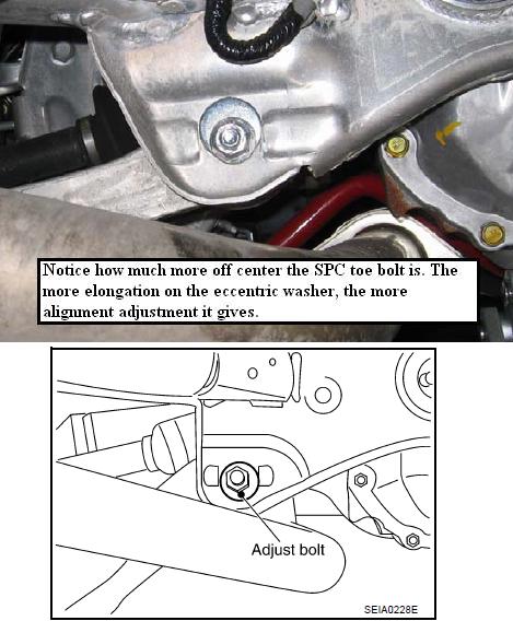

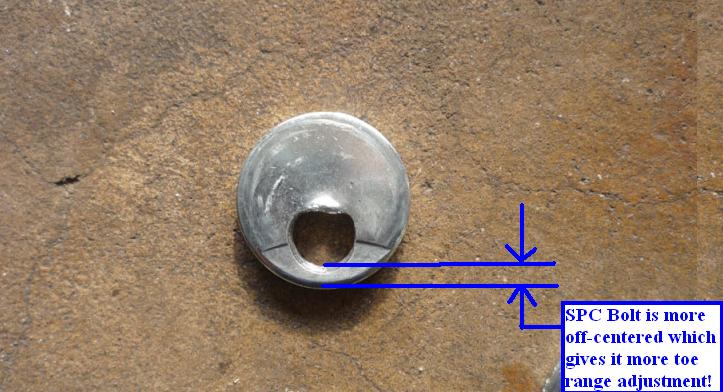

hands down - if your installing the SPC aftermarket 3 degree eccentric washer toe bolts then hands down you need to dremel/cut the doctor slot bigger per the template provided.!!!
WHY:
Simply because the slot currently is made wide enough for the oem 1.5 degree toe bolt. guys grab the oem bolt....then hold it in your hand and compare it to the spc bolt. if you hold the washers on top of each other they are the same dammn shape -
same shape --- so how is it 3 degrees over the 1.5 degree oem bolt - here is why - the bolt is more offset mounted....
Why further / damage:
So, if you install the spc bolt and don't cut the doctors pill slot - the bolt will NOT do a 360 degree turn within the raised subrame flat edges that the eccentric bolt sit in.
its literally physically incapable of turning around....
DAMAGE:
well, you install spc 3 degree toe bolts - drive to alignment shop, then you have an alignment guy with a long azz dammn socket wrench, fighting it over and tada!! you have now damaged your subframe, because the flat raised aluminum section edges will get deformed! and your car is forever ***'d!!!
Again - install spc toe bolts = use the dammn template and cut doctors pill slot!
-J

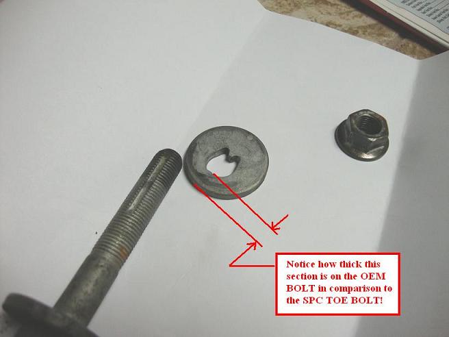

Taken from post 4 of my suspension 101 thread:
Originally Posted by JasonZ-YA
REAR - Camber and Toe:
LETS COMPARE OEM AND SPC TOE BOLT ECCENTRIC WASHERS SO THAT YOU CAN UNDERSTAND WHERE THE ADDED DEGREES OF TOE ADJUSTMENT COME FROM:
[/B]
OEM:
SPC:
ANOTHER PIC:
notice in the 3rd and 4th pic, how the bolt is between two raised flats - ie, the aluminum subframe is a stamped aluminum part - the raised sections will get folded over, pushed, damaged if you dont open the doctors pill.
-J
