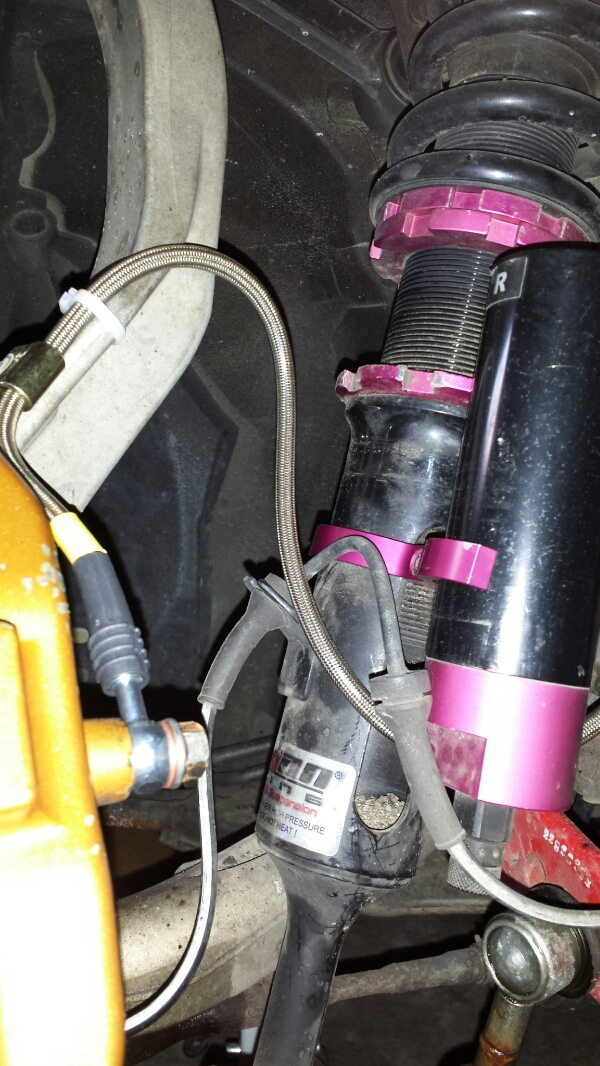

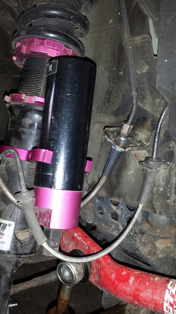

Here is how I ran mine. Dont pay attention to the dirt everywhere haha.
I used a nylon spacer to mount the bracket because it has a slight bend to it and wouldnt sit flush.
Attached Thumbnails stoptech ss lines-picsart_1397653837448.jpg   stoptech ss lines-picsart_1397653804980.jpg
