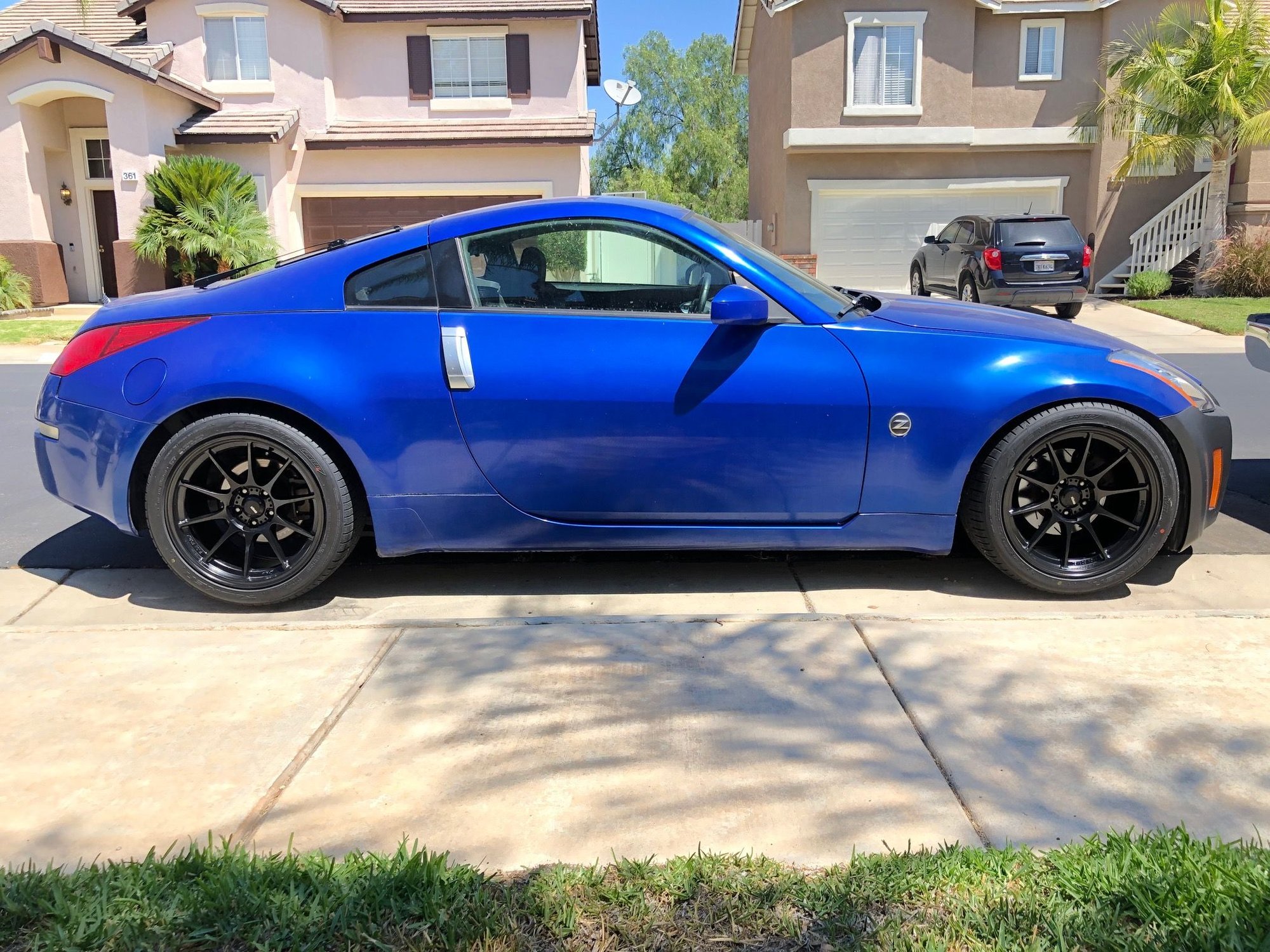

Mic mentions Bilstein B8 shocks. I have been running these and really like them. I mounted Tein S-Tech springs with the B8's. I like the setup. This setup drops the car less than an inch. The ride is actually a little "softer" than the stock setup.
Here is a link on this site discussing this setup: https://my350z.com/forum/brakes-and-...coil-over.html
This is a picture of my car with this setup:
