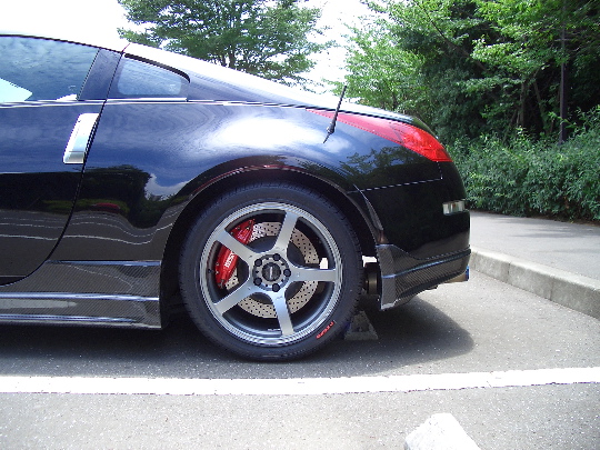

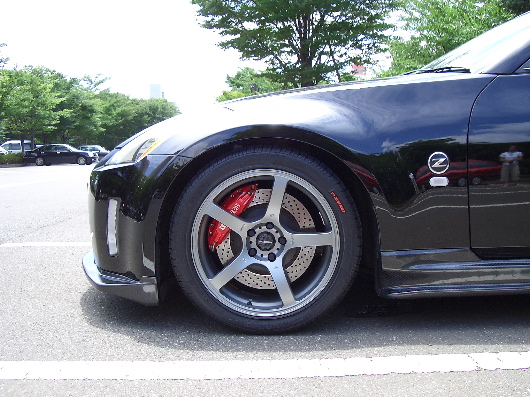

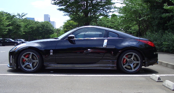

Old Jul 9, 2004 | 07:43 PM
ether's Avatar
ether
Posts: 694
Originally posted by ether
adding one more to the database.. just test fitted them, the Prodrive GC-05F 18x8.5 +23 will clear both front and rear 14" stoptechs
here of some pics mounted

Old Jul 9, 2004 | 07:47 PM
ether's Avatar
ether
Posts: 694
fronts
Old Jul 9, 2004 | 07:48 PM
ether's Avatar
ether
Posts: 694
rears
