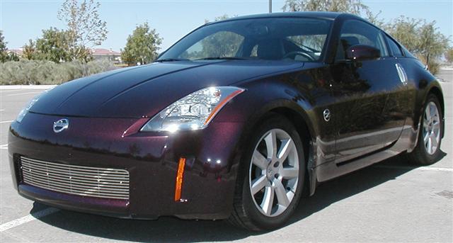

Zaph32, you did not "screw it up"! They, Zaino, just wants to insure that you are applying polish to a particle free surface. In all cases you should use Z6 after washing with Z7. Also, as you did after Z5 and before proceeding to Z2. You are going to like leaving on that Z2 overnight. If it has 10-12 hours to dry, you don't have to use ZFX. Just insure there is NO dust on vehicle before buffing. Use a "California Duster" if you have one. Anytime you want to apply another coat of Z5, do so! Just finish it off with Z2, with Z6 before and after. If you are impressed now, just wait until you buff off that Z2 that dried overnight.
Attached Thumbnails Zaino - Did it!  But a question...-mod-1-z-pic-8-oct-2003-small-.jpg
