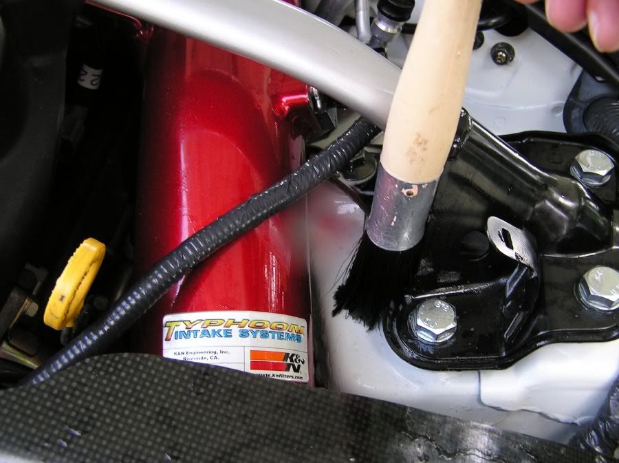

soap and water. just keep it off the intake. blow dry with leaf blower if you have one. use a small brush to agitate areas with heavy build up.

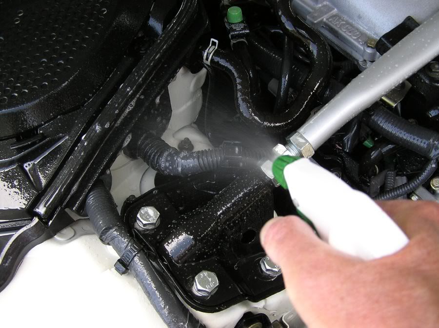

1) I use two spray bottles and fill one with soap and water the other with only water.
2) I wait until the engine is completely cold and gently spray water over the entire bay while trying to keep water off some of the electronic equipment.
3) I then follow up with the spray bottle with soap and try to let it sit for 10 minutes or so to soak in. Use a microfiber towel to gently remove some of the tougher accumulations of dirt
4) I spray it again with the water bottle filled with water only and make sure that all the soap is gone.
5) Dry the engine bay with a clean microfiber towel and enjoy your results:

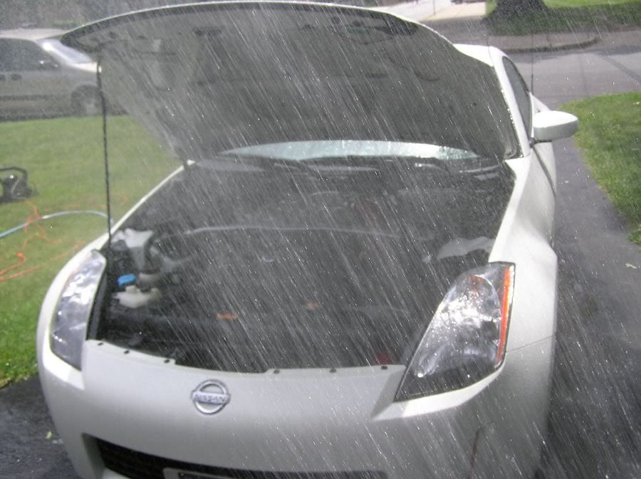

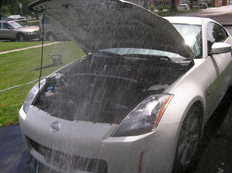

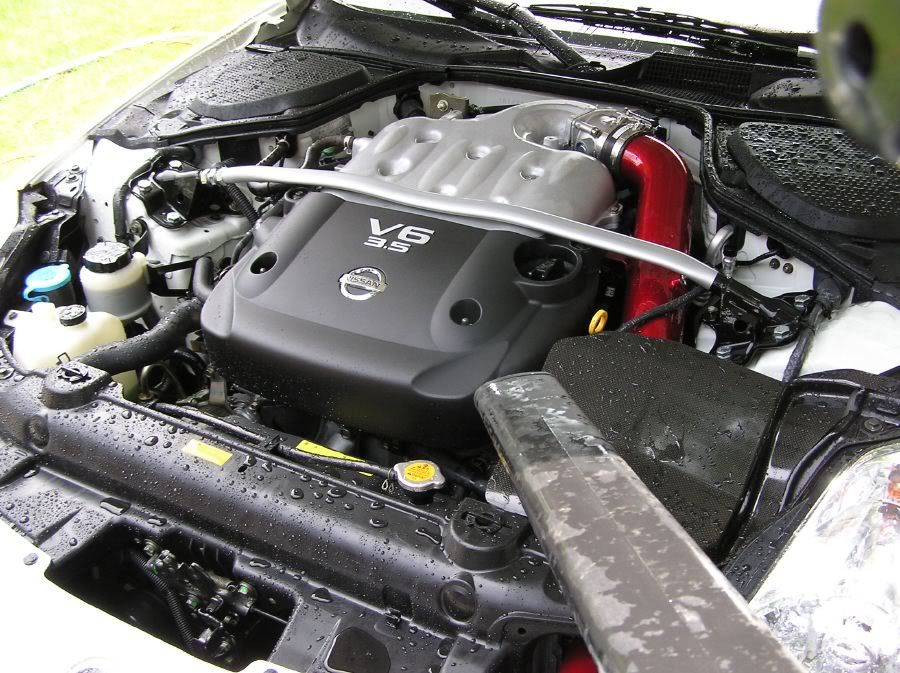

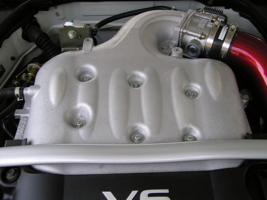

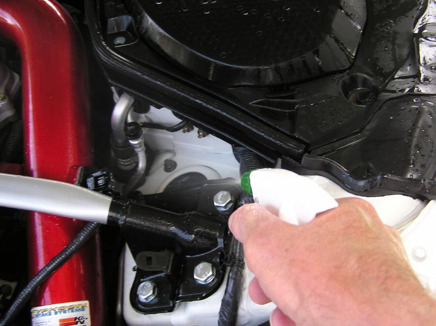

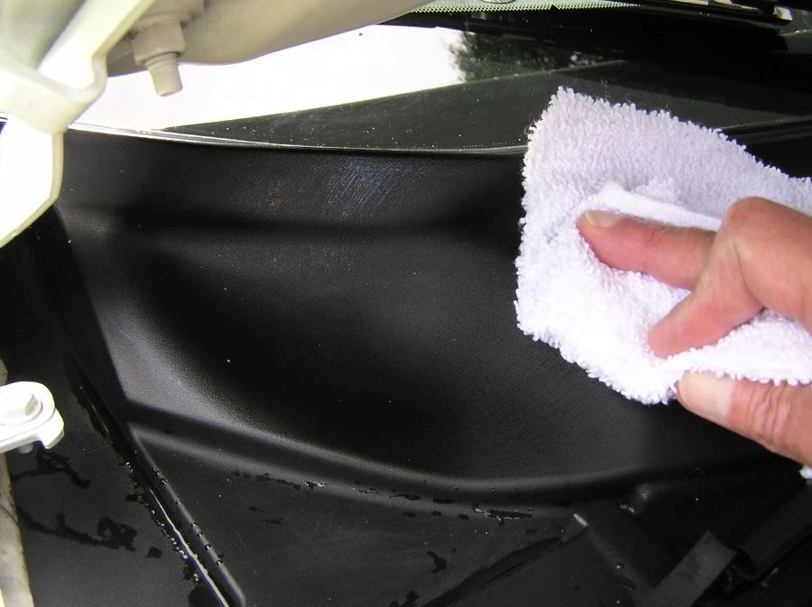

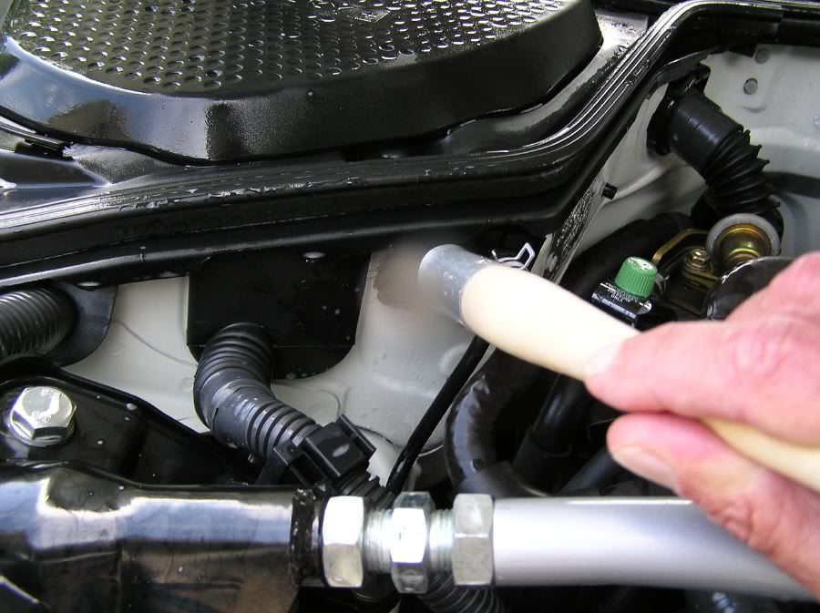

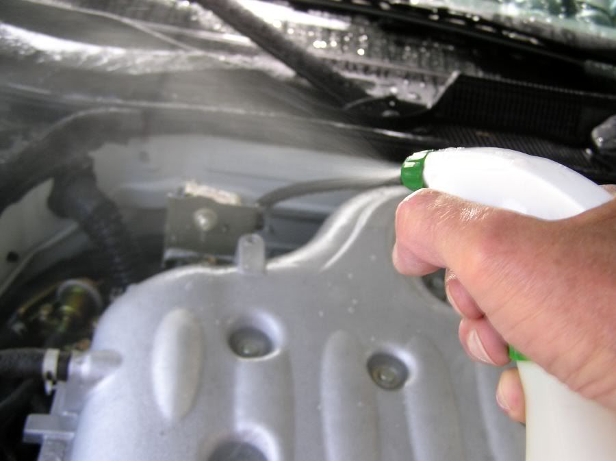

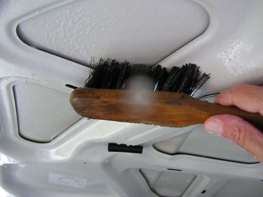

This is my method. I do not necessarily recommend that anyone use this method:
1. Rinse engine bay and underside of hood with a fine spray of water.
2. Prepare a spray bottle of 50 Mr. Clean/50 water.
3. Spray underside of hood and engine bay. Let sit for 10 minutes.
4. Agitate dirty areas with a assortment of brushes.
5. Rinse with fine water mist.
6. Dry with leaf blower.

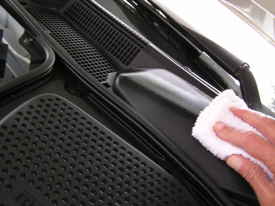

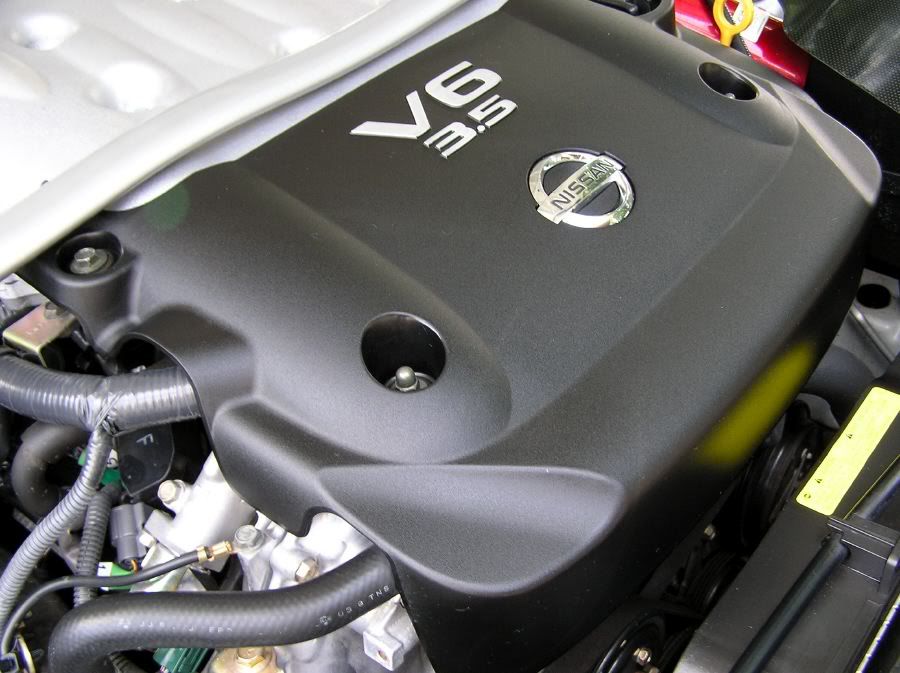

7. Apply dressing to damp cloth, then wipe plastic engine bay parts.

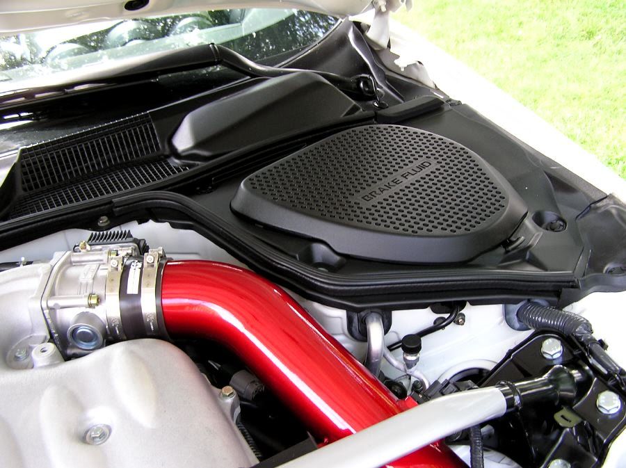

Photos below at 41,000 miles.
