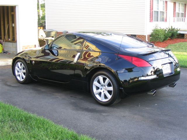

He is right when it comes to German paint. They do have a 'softer' clear coat vs. American cars, therefore they are generally harder to keep clean and keep swirl marks out of. I know for black cars, NXT is great. I have the SB Enthusiast...you tell me if it does a good job.

it eliminated the majority of the minor swirls on my SB, im very happy with the results of the NXT. doesnt seem to last as long as id like but the results & ease of application & removal keep me satisfied. i can apply & remove in about 30 minutes, very easy to remove. i usually do 2 coats to ensure i covered the entire but ive heard layering is a waste with this product..........
