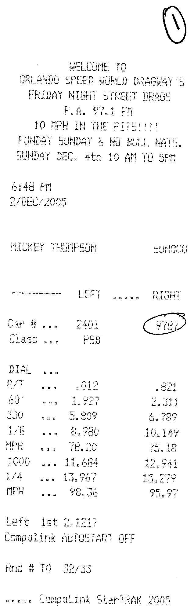

1st run
60' 2.311
1/4 15.279 @ 95.97 MPH
I slipped the clutch and still spun through third gear. Needed a better burn out.

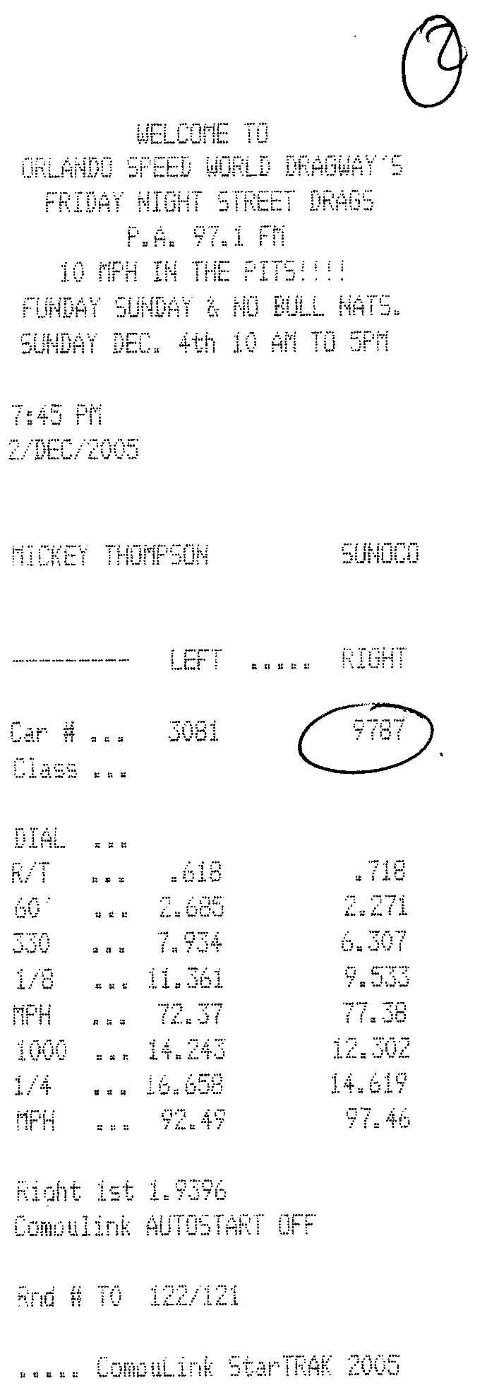

2nd run
60' 2.271
1/4 14.619 @ 97.46 MPH
OK launch. Still spun tires through third gear.

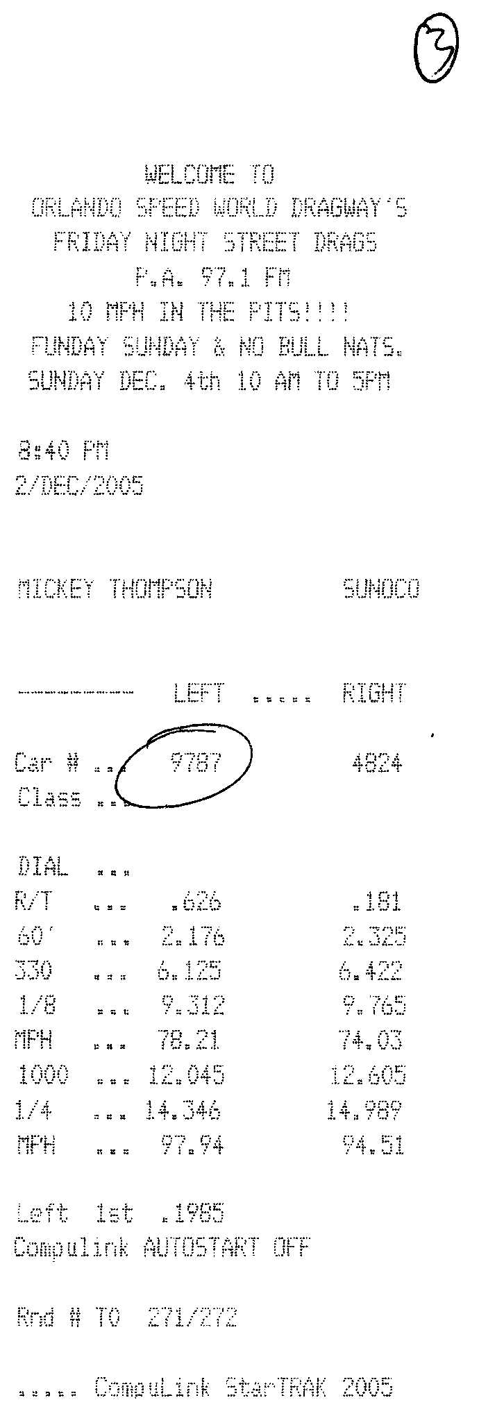

3rd run
60' 2.176
1/4 14.346 @ 97.94 MPH
Great launch. Spun tires through second gear.

Here they are.

Yeah I was right about your shifting speed needs to be faster. Your 2.1 60ft is good for your first time there but when you hit the 1/8 you should've been around 8.9-9.1 and hitting the 1/4 in the high 13's. If you keep pulling 60ft like that and get your shifting speed up to speed you'll definitely be right where you should be far as your times are concern. Good Luck next time!

Thanks for the time slips and I agree. You're picking up 19 mph in last 660 feet which shows your shifting technique. 2.0 60-foot times and better than 14.0 ET just takes practice. You're on you way.
