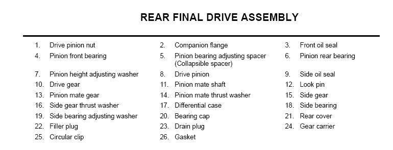

Sharif, thanks for the answers. Definitely you can count me in as one of the 5 for $1380 shipped. One more pesky question though. Looking at the rear final drive assembly pics I've attached from the service manual, can you point out the numbers of the extra parts that we need (bearings, races, seals)? I'm guessing 3,4,6,9,18?

If you go to a skilled mechanic/shop who has much experience with rear differentials and uses all the correct tools (i.e. bearing extractors, flange removers, etc.) ... the only thing that is not reusable and needs replaced are the 'oil seals'. The existing bearings and races could be reused (assuming they don't show signs of excessive wear).
If however, you went with Joe's 'bang bang' diff. shop ... they may brute force the bearings, races, and flanges out ... likely lead to the need for replacements.

two of part #18 and two of part #9. Ask for Steve at Courtesy Nissan Parts. 972-644-3942 and he can double check for you....since the diagram is a bit blurry. He is the parts manager, and order the same parts for me.
THX, in order to remove the stock bearing, you will likely need to heat it, and then use the proper bearing extractor to remove it cleanly. My tranny guy has done a lot of differentials, and recommended we replace it, as it will likely be damaged upon removal. Best thing is to have the new bearings and races handy, so if the old one is damaged on removal, you arent stuck waiting for 4 days for parts.
