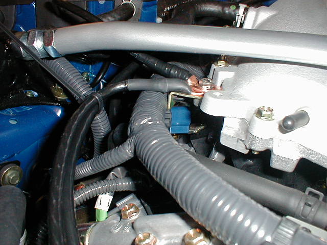

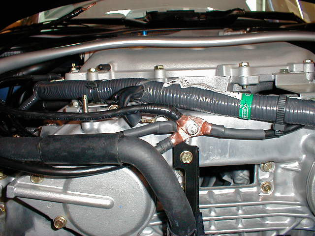

bhobson33 and i made our own grounding kit, we had all the cable connected to one location on the engine block, and then to various parts on the engine, from the main connection point back to the batteries ground, more like what i thought it should have been. seeems to make a difference
Somewhat different from what most are doing, but it seemed to make more sense to me this way

clean install brotha! black cables are the only way to go. glad you didnt go with neon blue, or yellow.
franklinz
Thanks, only thing i dont like is i ran out of shrink wrap, so the last 2 ends have electrical tape instead of shrink wrap, but ill fix that later

Originally posted by ares
dude are your connectors rusting? not good. glad I sprung for the gold plated monster cable connectors, even if its just pretty.
HAHAHA, they are copper connectors, and look good in person, I'd be a little concerned if they were on for 10 minutes(when the pic was taken) and already rusted
