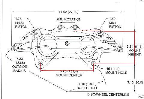

John! Now that you have your stock brakes can you help me out!
im looking for the stock caliper bolt hole distance, normally called the "mount center" this is the distance between both bolt holes measured from the center of each hole.
Also, looking for the mount height, this is the distance from the bolt holes to the top of the inside of the caliper pocket where the rotors fits and is what determines how big a rotor can go under the caliper.
Any help would be great, looking for both front and rear thanks bro!

hi krinkov,
if you or someone can post a pic from the nissan esm on what you are talking about, then i would gladly get the measurements for ya.

here ya go
I outlined in red the 2 measurement I need from the stock calipers, thanks bro!
