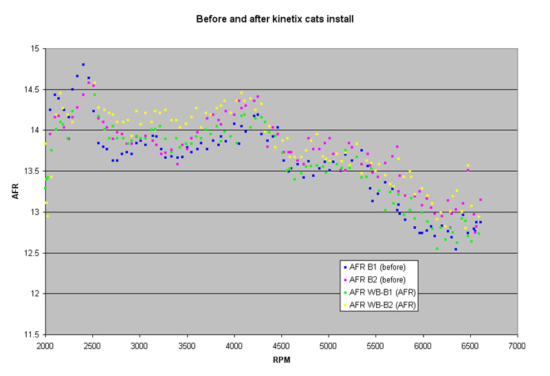

Um, your AFR looks pretty normal for not having tuning
check this out
Pinging has to do with combustion chamber efficiency (350z is not bad),
timing,
octane,
compression,
intake temperature....
basically those guys don't know what they're talking about or have not seen many 350z's
Also, their dyno sniffer might not be calibrated perfectly...
Attached Thumbnails My A/F is F'ed!-kinetix.jpg

Wired, so the HFCs leaned you out a little in the lower rpms? Then you probably gained a couple HP from it when you tuned. Is it loud?
