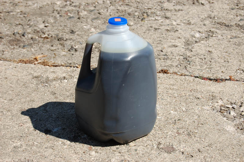

I changed my oil and filter after 225miles of driving (after v2 replacement) - This is what the oil looks like. Surprisingly dark after only 225 miles..
I am driving like a grandma. No hard acceleration, under 4k rpms (mostly under 3k), and I'm not even exceeding 50mph, no cruise control and if I am at a steady speed I shift gears and try to slow and accel a couple mph. I do occasionally and slowly get to about 3900 rpms, but, only maybe once every 50 miles or so. Very soft accelleration all the time. I really **** off people behind me
