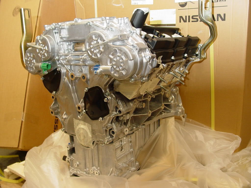

Old May 27, 2008 | 08:39 PM
  #3087
ZeeForce's Avatar
ZeeForce
Joined: Nov 2006
Posts: 1,604
From: Roseville, CA
Default V2 Long Block
Reposting this, it's been awhile.
