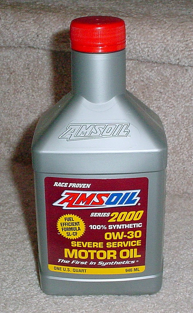

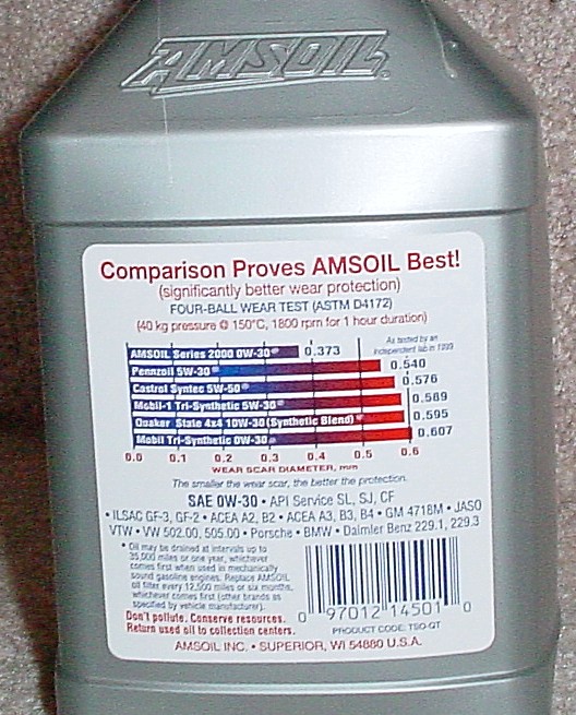

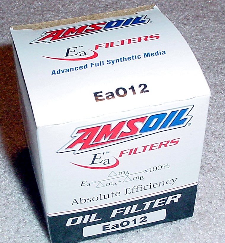

Good call on the Amsoil. I went out and got some Amsoil 0w30 this afternoon... Looks like pretty good stuff. :-)
Attached Thumbnails Oil Pressure and Oil Change. Is 10w30 OK?-dsc01959.jpg   Oil Pressure and Oil Change. Is 10w30 OK?-dsc01961.jpg   Oil Pressure and Oil Change. Is 10w30 OK?-dsc01976.jpg
