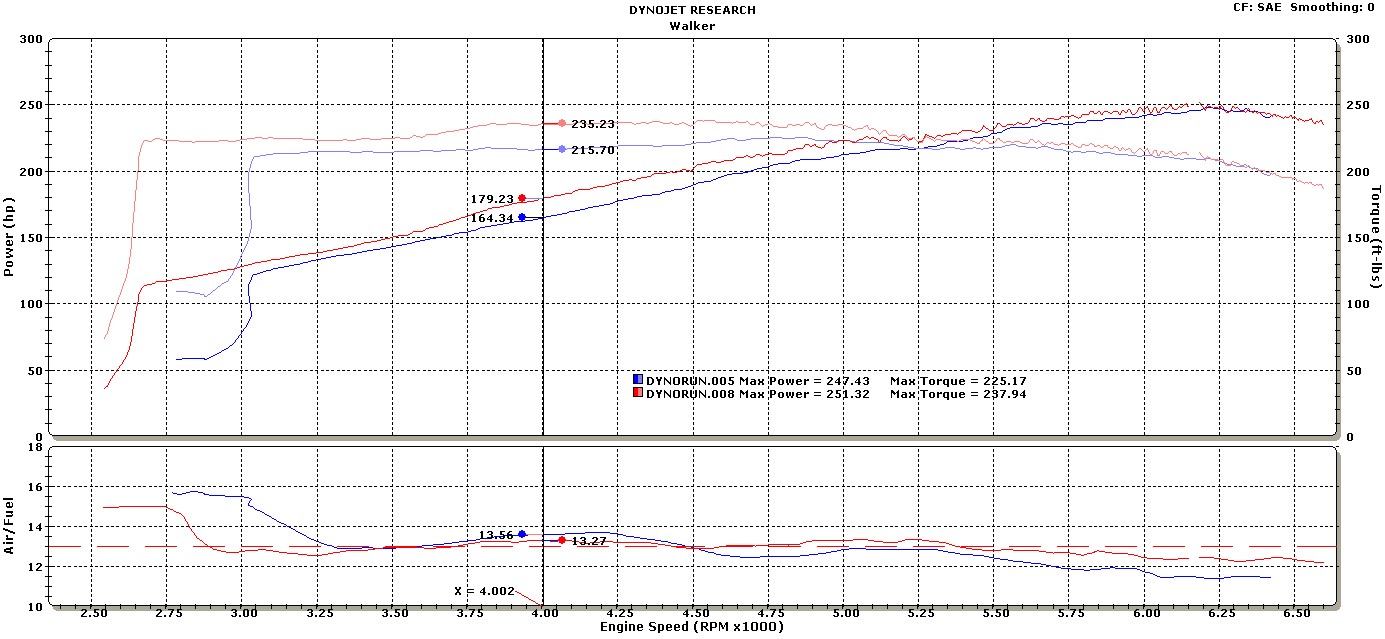

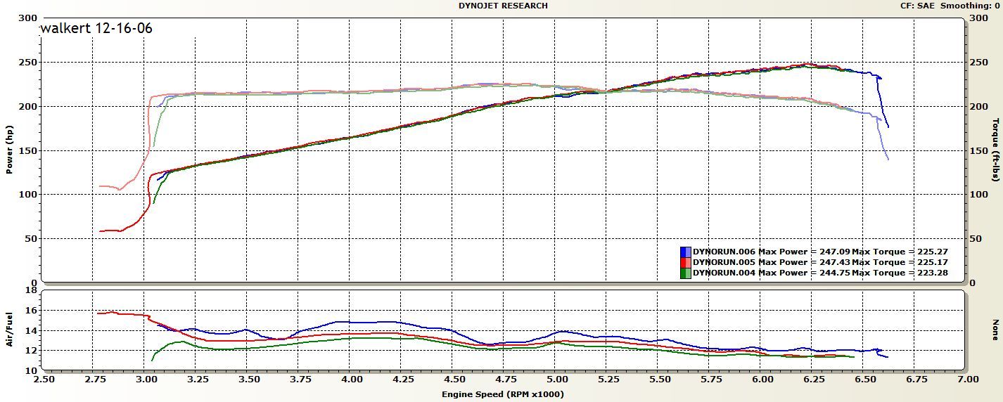

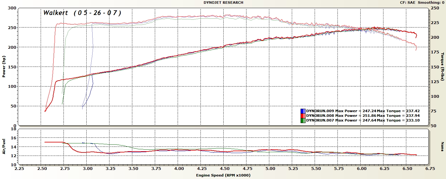

Just posting it up to see what you guys think, And do I need a utec?
The 12-16-06 dyno 3 runs
popcharger
5/16 spacer
nismo exhaust
The 5-26-07 dyno 3 runs
Aem intake
5/16 spacer
mild port and polish
strup headers
nismo exh.
And the overlay of the best from both days.
Installed by me
I had a popcharger but here in texas the thing would heat soak bad.
I also have TP but just have not had the time to install them and redyno.
Same dyno

it seems like you're not running very lean. a tune might help smooth that afr down and smooth out the curve...but i don't think it will make very big numbers.

it will lean you out more and you may gain in some areas where you are now rich, but you may loose in other areas without a tune

Lean out more, smell of un-burnt gas, gain another 2-3whp more. Thanks for showing that by adding headers only gained you minimal gains. I've always augured this point. For N/A............ not worth it!!! I would tune. If you'll be adding more, get the Utec hands down! You can always fine tune with the Utec to your cars needs, and every car is different. Re flash will do you good too but you can't fine tune it. Up to you and how much you want to spend.

The header only cost me 140 and took me 8 hrs to install. Soo for 20 hp more and 10 tq in my mid range It seems worth it to me. (see the last dyno)
What do I need to gain more top end?
Cams?
Or will I be able to gain more top end with a tune?

and your A/F is a little goofy (lean), so UTEC it!
