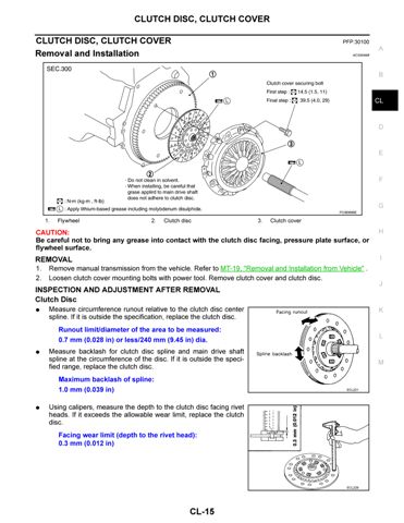

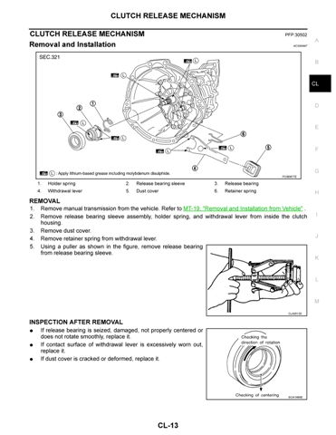

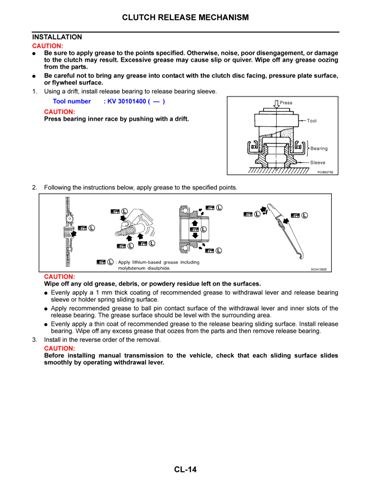

Can you see that the fork is moving the throwout bearing?
Is the fork bent?
Is it possible the fork is broken or bent where it attaches to the throwout bearing?
Can you see the area on the pressure plate where the bearing pushes against? I've seen these fingers break.
Also, I have seen the springs fail on the pressure plate.
You might just have to take it all apart to see what is wrong.
Attached are some pics. I hope they help.
Attached Thumbnails tranny diagnosis!-cl_page_1.jpg   tranny diagnosis!-cl_page_2.jpg   tranny diagnosis!-cl_page_3.jpg
Is the fork bent?
Thanks very much..I actually have the service "cd" for this car and have the same drawings...
Let me ask you this...should there be any gap at all between the pressure plate and the fork? Because it looks like the forks lays directly against the pressure plate tines...It looks like I'll be pulling the tranny this week...with an aftermarket clutch over a grand wouldnt it come with a new fork, bearing etc and wouldn't this stuff be stronger than stock??
