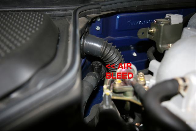

Lots of guys with FI get air in their cooling system. They seem to think it's from some kind of minor head lift of something. So they purge the air from the cooling system every few days.
You can purge the cooling system here:

Thanks Goth. I'll try that too.

Ok, I bleed the system today and it still did it. Some thing I noticed that I didn't before, I guess I have no over flow now. Does the Greddy kit not relocate it or something? All I have it the hose with a screw in it now.
