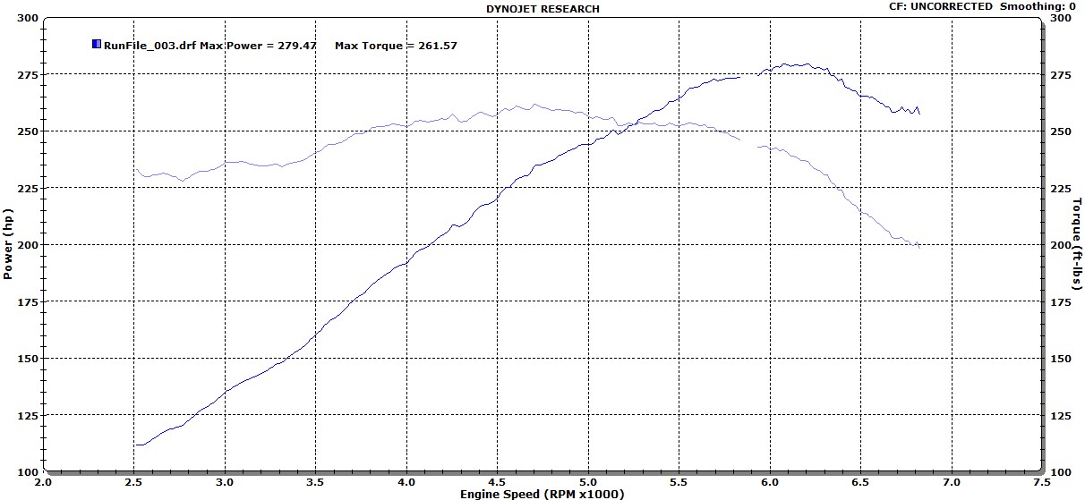

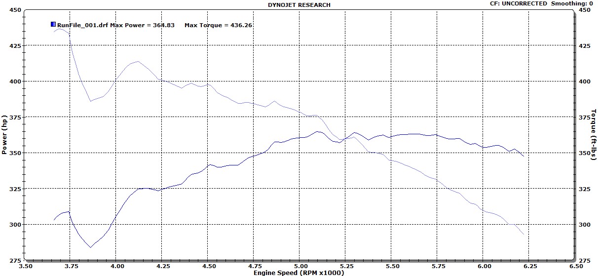

On my latest Dyno run on my 100shot I made over 440+ ftlbs of tork. This is really bothering me because my HP wasnt that high at 364. I would hate to go back to a 75 shot and lose Hp just to get rid of that monster tork.
My stock dyno that day was 278/262, the best n20 run was 366/438.
Should I worry about breaking the motor hardcore with that tork??? I have a window switch and never spray below 4000 or over 6000...But I mean 440+! I was never expecting it to be so high and dont want it to. Its kinda taking the fun out of the N20 becasue its making just a little toooo much tork and I have to go down in shot.

Yea for some reason the dyno Pulls were all over the place compared to the Na runs. The AF was perfect on all N20 runs at around 12's and 11's. Uprev does there job well.
do you have an aftermarket fuel pump? I'm assuming its a wet kit, cause you can see where the fuel pressure drops right after the hit and the pump has to catch back up.
You are in that grey area for stock rods....and nitrous is "harder" on the motor than FI at same power levels.
Personally I'd back it down to the 75 shot.

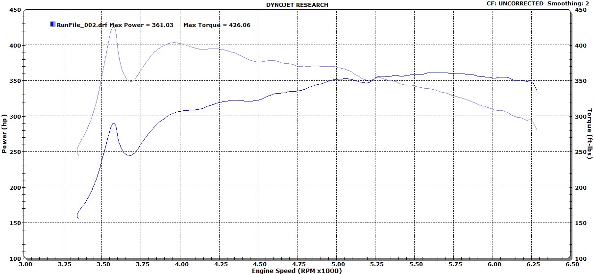

heres the second run with lower bottle psi.
Stock fuel pump. Uprev said the AF was great. Im not sure if that has anything to do with the fuel pump psi or fuel pump not being able to hang.

Its inherit in all wet setups. really no way around it. As long as you're not crazy aggressive on the tune that part won't be a problem.
but like I said you're tq is in that grey area.
Now a good question would be, when the FI guys pop the stock motor is it happening during the tq peak or the hp peak??????? that part I don't know.

I wonder that also. Although I have friends that have popped there motors backing down there driveways. I think when the rods are ready to go they just go. Maybe they weaken overtime and eventually just give in?
if you keep spraying like it does in the first dyno chart its just a matter of time. im curious is to why your chart looks the way it does. not familiar with dynos with n20. but im almost positive it shouldnt look like that.
