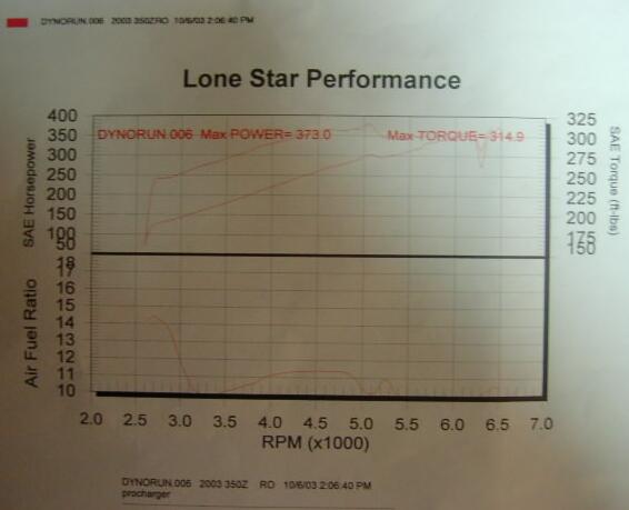

Default 373.0 rwhp see dyno
Finally got around to getting that free dyno tune from Grubbs. I took the procharged Z to Lone Star Performance in Garland Texas. They found and fixed an air leak problem and then adjusted the sliders for the max rwhp they could get without the car detonating

man those are some great numbers congrats !!!!!!

Nice numbers.

Those a super numbers with a good AFR setup. Those guys did a great job tuning the car by the looks of things.
Why does the AFR start so high down low though? Is that just the dyno setup?
more like something to do with the fuel management system. They said it has a tendence to throw fuel in no matter what they do to the sliders. They played with the car for over an hour trying different settings. I agree these guys know what they are doing. They have been with ATI for a number of years so the Z system is old hat to them

Outstanding Numbers !!!!!!!
