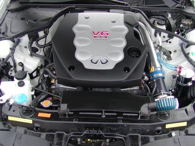

now in my turbo 350, i did not want the gases going in to the non-charge side of the intake, as it would make oil accumulate in the i/c again... so, i was going to put in a catch can. i then did some research and looked at a bunch of diagrams and actual pictures, and realized the oil baffles on the Z are designed really well, and not a whole lot of oil should be coming out...
so, we just put a breather filter on the driver side valve cover, and left the pcv valve (on the passenger side) run back into the intake manifold upper collector. there is no oil on the filter after 4000miles (yes 4000mls in 3 weeks
), so i am not going to put a catch can.
now, this will still allow HCs (and oil mist) back into the manifold, (from the pcv valve), but atleast it is not fouling up my intercooler. anyone who has tore down the intake plenum knows even on a stock Z, there is a fine oil mist covering the inside walls...
so back to how to route the hoses to you catch can... you have some options...
1) if you want no HC blow-by back into your combustion, by something like the Jaz Can above, and route both the pcv and intake breather hoses to it. just remember to cap the nipple on the manifold, and on the intake tube. your car will smell like an old muscle car
2) if you dont want any oil in your intake plumbing (pre-throttle body), you can either just put a breather filter on the driver valve cover and cap the intake tube nipple (this will stop all oil AND all HC).... OR run the greddy or helix catch cans in line on the hose that connects the driver side valve cover to the intake tube. the first option will again leave your car smelling like a muscle car, while the second one will allow the HC back into combustion, but keep the oil from returning.
3) if all you want is to stop oil all together, but let all HC still be combusted... you need 2 catch cans, one for the pcv, one for the "high-load", running in-line on the hoses.
), so i am not going to put a catch can.now, this will still allow HCs (and oil mist) back into the manifold, (from the pcv valve), but atleast it is not fouling up my intercooler. anyone who has tore down the intake plenum knows even on a stock Z, there is a fine oil mist covering the inside walls...
