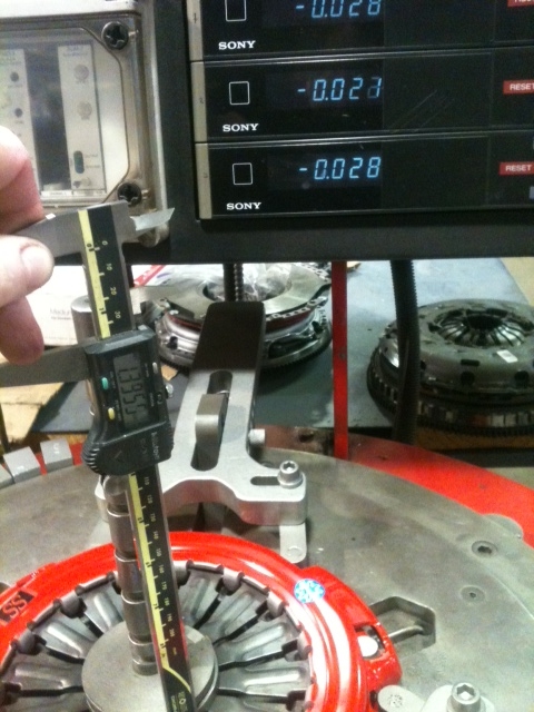

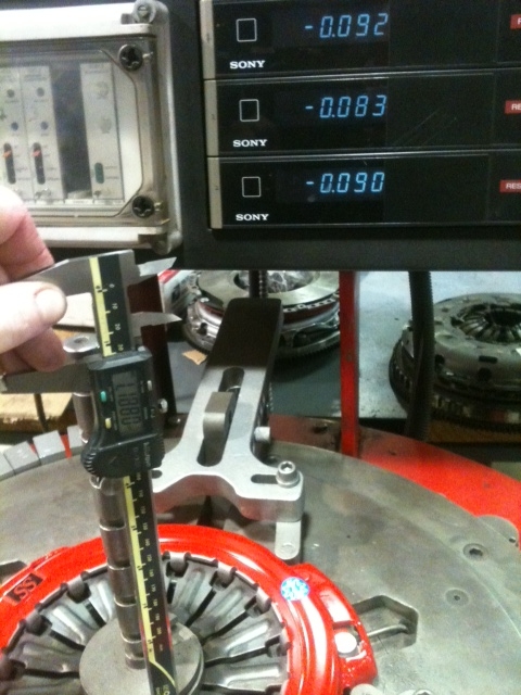

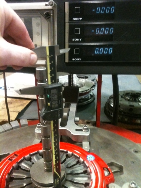

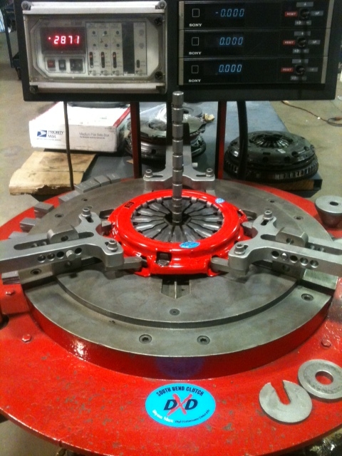

Any chance you have a picture or can take one of what you're describing here? Thanks.

More then happy to. The pictures show our SS 350z pressure plate in it's different stages of release. The digital calipers shows the height from the fingers of the diaphragm to the table which represents the flywheel surface. The digital readout in green in the background shows the lift of the plate in the pressure plate in 3 locations. The digital red readout is plateload.
(FYI, there is a digital readout that shows the reading I am manually taking with the calipers, but the sensor is busted and I'm waiting on the new one.)
At .241 of bearing or finger travel, the pressure plate starts to lift .021-.028 and by .448 the pressure plate is fully released .083-.092. To us, fully released is .060 with a puck and .080 with a full face disk. Less with a puck because of the lack of marcel or cushion bewteen friction surfaces.
