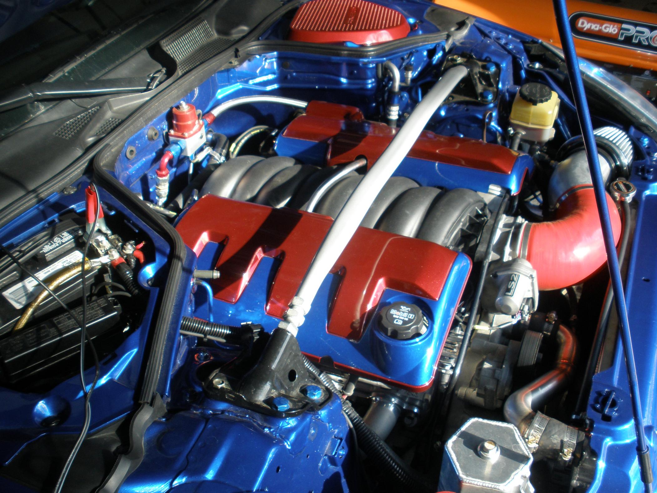

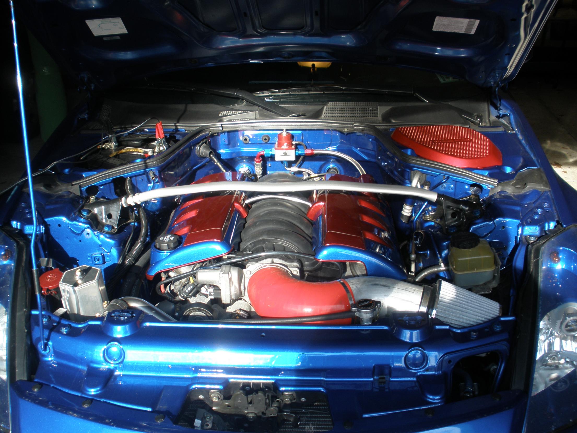

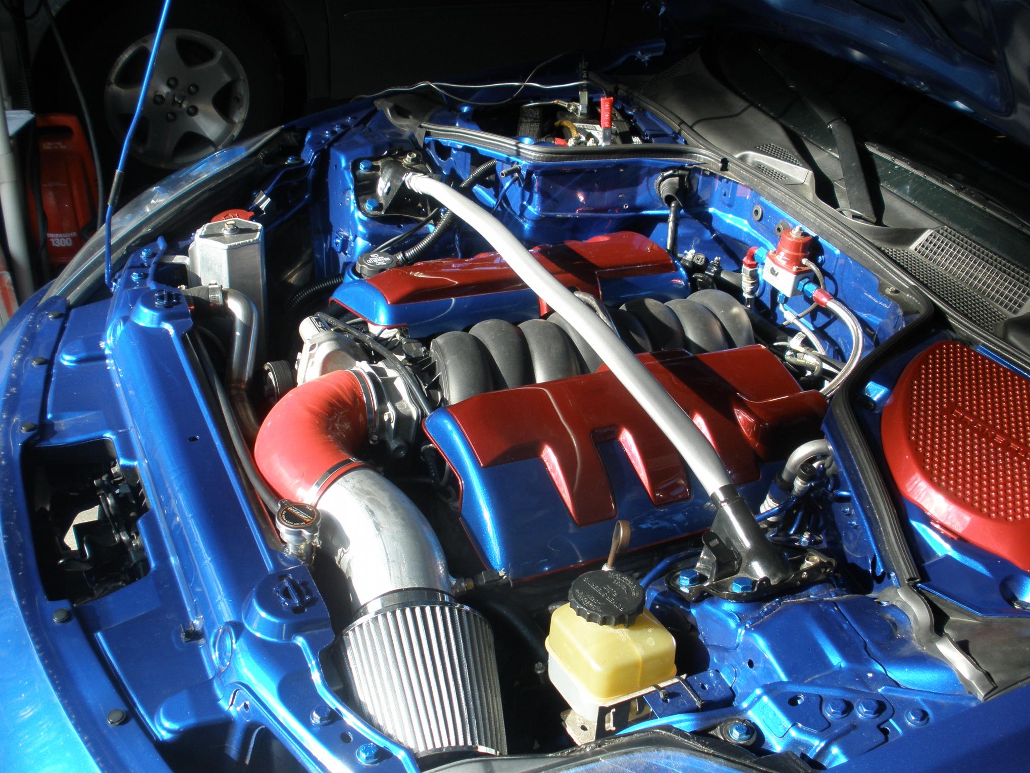

Got my engine covers back from paint:
My SIKKY LS2 install thread-p1062159.jpg My SIKKY LS2 install thread-p1062160.jpg My SIKKY LS2 install thread-p1062161.jpg
WOOT!!!

Matches perfectly.

looks amazing cass, btw what are you planning for another vq? i see that you have been asking around about some stock blocks lol

lOOKS GREAT CHRIS!

those engine covers dont look like they can hold power

Battery charger? lol Hey where did you get your silicone bend off the TB? It looks like more than a 90* bend. I'm getting ready to order my parts but have been debating of doing a 90* or a 135* I'm digging the valve covers and impressed it all match so well.

www.turbohoses.com
I got a 135* and Franz cut it down to where it needed to be. The clearance is so tight that it had to bend more than 90* to be 4" all the way to intake.
SHHH... its a secret!! I love my new setup and NOTHING will change this car back to a VQ.

you engine bay looks like superman lmfao yuo get any vaccuum leaks with that port unplugged from the brake booster?
Come on mang... would I do a noob moove like that?!?!?! I put the check valve and hose for that inside the brake compartment, the hose is just sitting there... empty and alone.... forever.... I've already been told my car looks like Optimus Prime, I'm fine with it.
